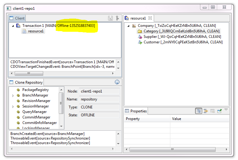

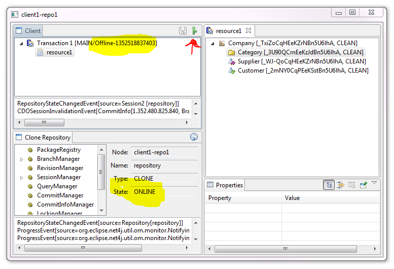

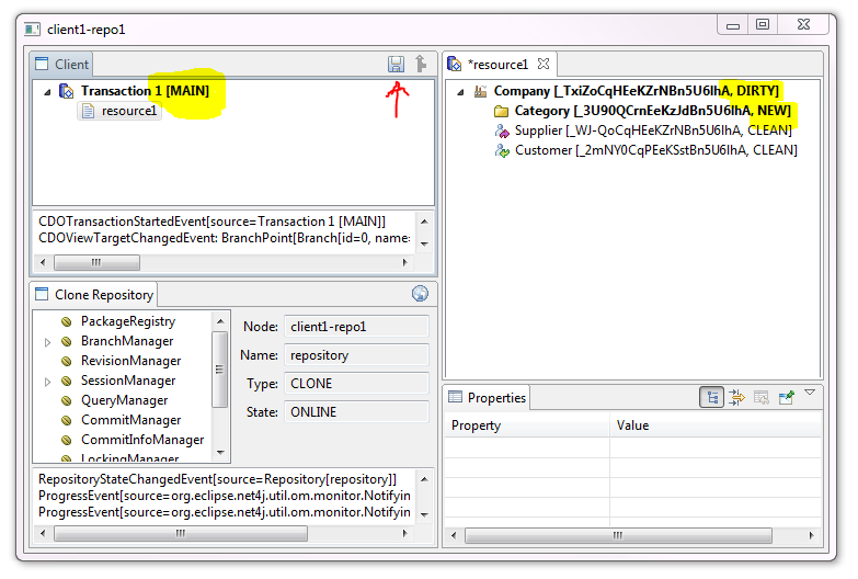

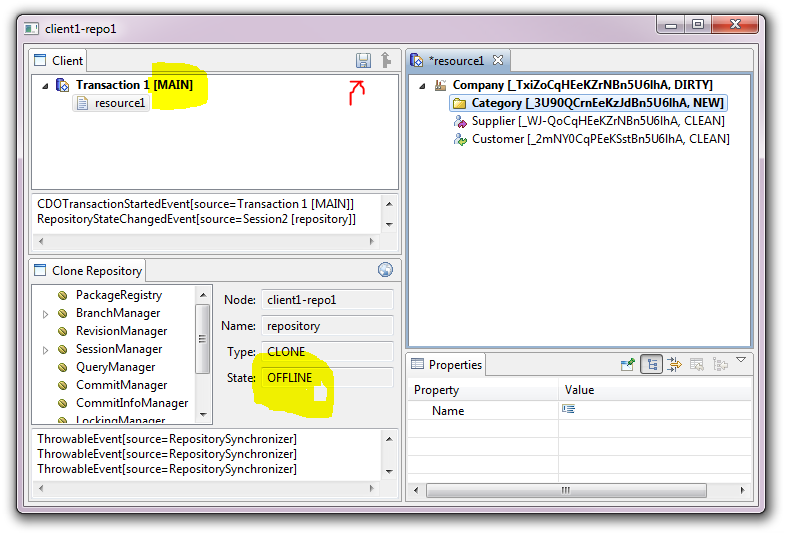

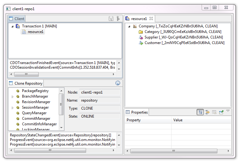

You've found it! It's not not 100% finished, yet. I'm still working
on one bug in the core (related to switching the view/transaction
target/branch) that I uncovered with the new example suite. I plan
to write a blog about the example this weekend when I'm done ;-)<br>
<br>
<br>
<blockquote cite="mid:k7k14u$ije$1@xxxxxxxxe.org" type="cite">
My question: when the client goes offline and it commits a
transaction, then an offline branch is created. On reconnection:
can I merge the offline branch with the initial branch, from the
main server?
<br>
</blockquote>
Yes, but it requires the pending changes I mentioned above. From my
local workspace I can already do this:<br>
<br>
<img src="http://www.eclipse.org/forums/index.php?t=getfile&amp;id=12247" alt=""><br>
<br>
<img src="http://www.eclipse.org/forums/index.php?t=getfile&amp;id=12248" alt=""><br>
<br>
<img src="http://www.eclipse.org/forums/index.php?t=getfile&amp;id=12249" alt=""><br>
<br>
<img src="http://www.eclipse.org/forums/index.php?t=getfile&amp;id=12250" alt=""><br>
<br>
<img src="http://www.eclipse.org/forums/index.php?t=getfile&amp;id=12251" alt=""><br>
<br>
<br>
<img src="http://www.eclipse.org/forums/index.php?t=getfile&amp;id=12257" alt=""><br>

<img src="http://www.eclipse.org/forums/index.php?t=getfile&amp;id=12262" alt=""><br>

<img src="http://www.eclipse.org/forums/index.php?t=getfile&amp;id=12263" alt=""><br>

<img src="http://www.eclipse.org/forums/index.php?t=getfile&amp;id=12264" alt=""><br>

<img src="http://www.eclipse.org/forums/index.php?t=getfile&amp;id=12265" alt=""><br>

<img src="http://www.eclipse.org/forums/index.php?t=getfile&amp;id=12266" alt=""><br>
<br>
<img src="http://www.eclipse.org/forums/index.php?t=getfile&amp;id=12267" alt=""><br>
<br>
<img src="http://www.eclipse.org/forums/index.php?t=getfile&amp;id=12268" alt=""><br>
<br>
<img src="http://www.eclipse.org/forums/index.php?t=getfile&amp;id=12269" alt=""><br>
<br>
<img src="http://www.eclipse.org/forums/index.php?t=getfile&amp;id=12270" alt=""><br>
<br>
<img src="http://www.eclipse.org/forums/index.php?t=getfile&amp;id=12271" alt=""><br>
<br>
<img src="http://www.eclipse.org/forums/index.php?t=getfile&amp;id=12272" alt=""><br>
<br>
<img src="http://www.eclipse.org/forums/index.php?t=getfile&amp;id=12273" alt=""><br>
<br>
<img src="http://www.eclipse.org/forums/index.php?t=getfile&amp;id=12274" alt=""><br>
<br>
<img src="http://www.eclipse.org/forums/index.php?t=getfile&amp;id=12275" alt=""><br>
<br>
<img src="http://www.eclipse.org/forums/index.php?t=getfile&amp;id=12276" alt=""><br>
<br>
<img src="http://www.eclipse.org/forums/index.php?t=getfile&amp;id=12277" alt=""><br>
<br>
<img src="http://www.eclipse.org/forums/index.php?t=getfile&amp;id=12278" alt=""><br>
<br>
<img src="http://www.eclipse.org/forums/index.php?t=getfile&amp;id=12279" alt=""><br>
<br>
<img src="http://www.eclipse.org/forums/index.php?t=getfile&amp;id=12280" alt=""><br>
<br>
<img src="http://www.eclipse.org/forums/index.php?t=getfile&amp;id=12281" alt=""><br>
<br>
<br>
