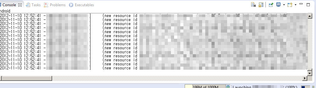

the attachment(blinded) is....the log when blocked situation.
Is that could be a one of clue?

The blinded picture of your *Android* console shows no hint at JDT being the culprit.
For more detailed information on what's consuming time you may want to follow the advice at http://wiki.eclipse.org/How_to_report_a_deadlock even if it's not a deadlock.
Note that the ADT is not developed at Eclipse.org but at google.
