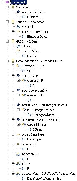

i've created an EMF-Diagram (see attachment) and i try to add an Adapter to the list in my DataCollection.class
when i try to add an Adapter to the list (as to every other EObject i fail, as my IDE tells me there is no .eAdapters() function on the EList
i remember that i already did an example using a list, so it IS possible.
can you help me and point me my mistake?
thanks in advance
Re: add Adapter to List [message #974886 is a reply to message #974844] Wed, 07 November 2012 07:09 Go to previous messageGo to next message
You are not adding the adapter to the List but to the EObject containing
the list.
Tom
Am 07.11.12 12:28, schrieb Ludwig Moser:
> thanks in advance
Re: add Adapter to List [message #975986 is a reply to message #974886] Thu, 08 November 2012 03:20 Go to previous message
thanks!
strange... its working fine if you do it right Wink
