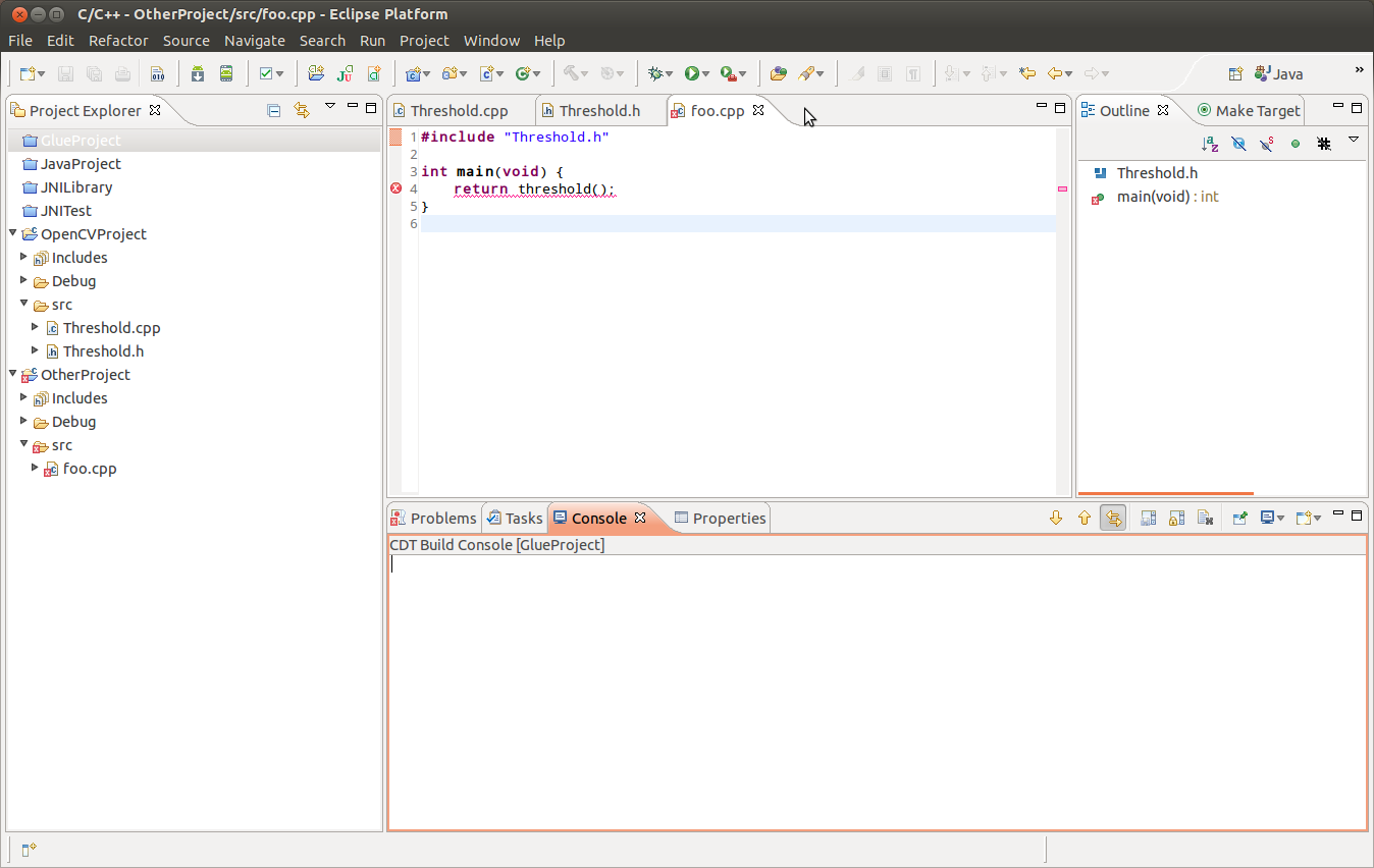

I have a project which uses some functions from OpevCV and it compiles into an executable and works fine. Now I want to have a new project which uses some of the functions defined in the first one. I can't get the two to compile and link together.
I have
#include "..."
in the relevant files in the new project, I've added the old project to the referenced projects of the new project and in the build settings of the new project, I've added the source folder of the old project as an include (-I gcc option).
I've attached a screenshot of my Eclipse in case it's helpful. The error given by the compiler is at the bottom:
Building target: OtherProject
Invoking: GCC C++ Linker
g++  -o "OtherProject"  ./src/foo.o
./src/foo.o: In function `main':
/home/max/opencvjni/OtherProject/Debug/../src/foo.cpp:13: undefined reference to `threshold()'
collect2: ld returned 1 exit status
make: *** [OtherProject] Error 1

Here is the code in those other files in the other tabs of the screenshot:

I found a solution that for me works but obviously there is a drawback. I use this solution especially to test a project using unit tests or similar tecniques.
Suppose to have a workspace containing the Work project and the WorkTest project, if I need to compile a C file contained in Work I click on File/New/Other then in the popup window I choose General/File then I click on the button Advanced>> (in the bottom part of the window) then I click on "Link to file in the file system" and finally I click on "Browse" button and select the source file to link in WorkTest project.
I know, it is a long procedure but it establishes a link between the project and the source file of another project that may be a viable solution for you.
For me is ok, of course every time you change the linked source file you have to build every project where it is used.
I don't like so much to link source files in this way among different projects, in this situation I prefer a simple Import or better a working copy extracted by a git repository so that I can manage the changes without loosing the history of the original file.
