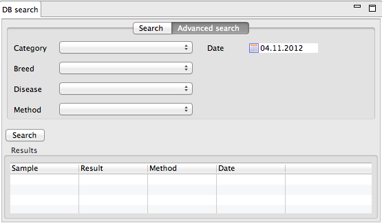

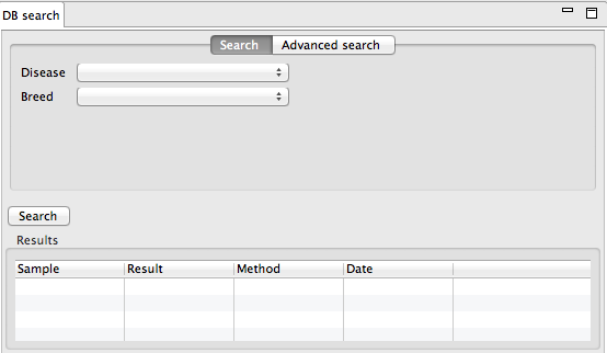

I have a ViewPart with GridLayout and two children: Tabfolder and Table. In tabfolder I have two TabItems of different height. Is it possible to resize the tabfolder according to the height of the selected tab?
Here are some screens. First the part with ,,smaller'' tab selected - I want to get rid of the blank space.
index.php/fa/12207/0/
(The ,Results' has FILL_Vertical and grab vertical flags)
and here the second tab.
index.php/fa/12189/0/
Thanks a lot
regards
matus
[edit1]wrong screenshot[edit1]
[Updated on: Tue, 06 November 2012 02:47] by Moderator

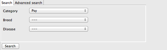

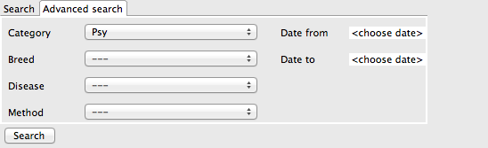

Re: SWT Tabfolder update size according to selection [message #980174 is a reply to message #978188] Sun, 11 November 2012 07:23 Go to previous messageGo to next message
Hi Grant,
thanks a lot for your suggestion but in my case the results are not quite what I expected.
I switched the TabFolder to CTabfolder and in selection listener I added the pack request.
searchCriteriaTabFolder.addSelectionListener(new SelectionAdapter() {
	public void widgetSelected(SelectionEvent e) {
		searchCriteriaTabFolder.pack();
now the tabfolder did pack its contents, but still only to the size of the largest child.
here are the screenshots:
smaller child after pack()
index.php/fa/12293/0/
larger child
index.php/fa/12294/0/
am I missing something here?
also is there a way to only accomodate height but not width?
thanks
matus
Re: SWT Tabfolder update size according to selection [message #985685 is a reply to message #980174] Thu, 15 November 2012 11:56 Go to previous message
I see, I overlooked that part of your question. The implementation of
CTabFolder.pack() asks each of its tabs for its preferred size, so even
tricks like making the content of non-visible tabs invisible will not
help here. One thing you could try is to set the size (or if you're
using layouts, the size hints) for all controls on non-visible tabs to
1,1, so that their preferred sizes will become very small. Then fix
these sizes (or in the case of layouts, get rid of the size hints) for a
given tab when it is selected.
That being said, having a tab folder whose size changes on every tab
selection is not typical, and may seem jumpy to the user. Just a
suggestion to re-consider whether this is actually a good thing to do.
