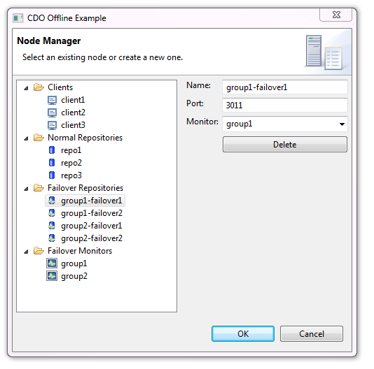

I've already fixed the way the cdo-server.xml gets copied. Now
supportingEcore is set to false and the idGenerationLocation to
CLIENT.<br>
<br>
I'm also working on a larger RCP based example suite:<br>
<img src="http://www.eclipse.org/forums/index.php?t=getfile&amp;id=12179" alt=""><br>
<br>
It'll be available sometime next week...<br>
<br>
Cheers<br>
/Eike<br>

Thanks for the excellent news!
I'm looking forward to the running the new example. The screenshot looks very... tempting/teasing Smile
Cristian.
