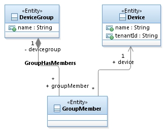

My application is multitenant network management system where the tenants have the devices managed by my application.
I have to support grouping of devices across tenants where one device group can have many devices and one device can be member of many groups. The attached class diagram represents major entities and their relationships. M:N relationship between DeviceGroup and Device is implemented by GroupMember entity. Association of DeviceGroup and GroupMember is a composition and in ORM it has cascade=ALL.
Devices are partitioned by tenantId property and the partitioning policy is defined by a mapping table which defines explicit mapping of tenant to partition, that is, this table has two properties; tenantId, partitionId.
Since predefined partitioning policies do not support this kind of partitioning I developed my own partitioning policy which is driven by this mapping table.
Since GrouoMember entity references the Device entity it has to be portioned by Device.tenantId too. I developed partitioning policy which does that, that is, which gets the corresponding instance of Device and then based on tenantId value and based on the mapping table it returns the appropriate list of Accessor.
Since DeviceGroup is parent of partitioned entity it has to be replicated to all partitions in which their members exist. I developed my own replication policy which analyzes the members and accordingly returns appropriate list of Accessor.

I started with creation of DeviceGroup which has one member device from partition P1 and one from partition P2. Everything went fine; DeviceGroup instance is replicated to partitions P1 and P2, appropriate instances of GroupMember are created in P1 and P2 and all referential integrity constraints are obeyed.
Then I ran the next test; I added new device to already created DeviceGroup where that new device member is located in partition P3. When I call EntityManager's persist (deviceGroup) I got referential integrity constraint violation in partition P3. EclipseLink tried to insert GroupMember record in P3 but corresponding DeviceGroup record did not exist there.
IMO, EclipseLink should recognize that DeviceGroup record does not exist in partition P3 and it should insert it. My replication policy for DeviceGroup has returned all 3 accessors (for P1, P2 and P3) but EclipseLink generated the UPDATE SQL statement for all of them instead of generating the INSERT statement for partition P3.

Again, I want to replicate DeviceGroup entities to the nodes where their members exist, not to all nodes.
I have created new DeviceGroup instance with two members; one located in partition 1 and second one in partition 2. That worked fine, that is, my DeviceGroup instance is replicated to both partitions; 1 and 2.
But when I added third member which is in partition 3 I was expecting that DeviceGroup instance will be replicated to the partition 3 too by EclipseLink.
There is a workaround if I replicate each entity with the replication policy to all nodes instead to the nodes where the members of collection exist but that is not what I wanted to do. Adopting this strategy, I can address the first use case when new DB partition is added; in that case I have to develop some DB setup utility which replicates all tables annotated with replication policy.

I am replicating DeviceGroup to each partition in which DeviceGroup has the members (Device) in order to satisfy local referential integrity constraints. I am using my own policy which analyzes the members (Device) and returns set of partitions in which members exist.
Initially I had two members, one from partitions 1 and one from partition 2 and my policy returned these two partition. That works fine, that is, DeviceGroup is replicated to these two partitions. Then I updated collection of members adding third member which is in partition 3. My policy returned now 3 partitions, 1, 2 and 3, but EclipseLink did not replicate DeviceGroup to partition 3.
