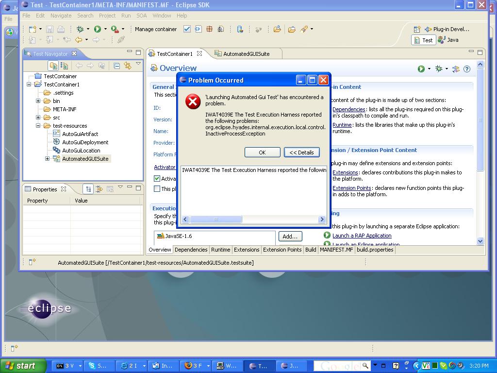

I'm having problems running the example
http://www.eclipse.org/tptp/test/documents/userguides/Intro- Auto-GUI-4-5-0.html#2.2.3
When i get to this step I experience the following error after the testbench
is launched to run the test? Any ideas? Do I need to start and agent
controller? The document mentions that i should not have to if I'm running
local. I'm able to run the quick mode without a problem.
thanks,
matt
  • Attachment: error2.JPG
    (Size: 137.34KB, Downloaded 461 times)

Hi Matt,
You do not need the Agent Controller if you are running local. There is
an Integrated Agent Controller packaged as a set of Eclipse plug-ins in
TPTP. Is your location pointing to the local host? Can you attach your
project (zipped)?
Paul

Hi Paul,
thanks for the reply. If by local host you mean local_deployment in the run
configuration, yes it is. Is there another place that local needs
specified?
Do I need to add the agent controller to the path?
thanks,
matt

Hi Matt,
Yes, I was referring to the local_deployment in the launch
configuration. There is no need to install/configure the Agent Controller,
since the Integrated Agent Controller is used.
Are you using TPTP 4.5.0?
It appears that your TPTP installation is not correct. Can you try
reinstalling TPTP and the AGR, and restart Eclipse with the -clean flag? If
this step does not resolve your issue, please attach your project.
Paul
