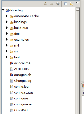

Maybe I'm missing something, but I don't see anything that might refer to Binaries.
index.php/fa/12422/0/

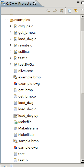

The directory 'examples' has a number of executables:
index.php/fa/12426/0/

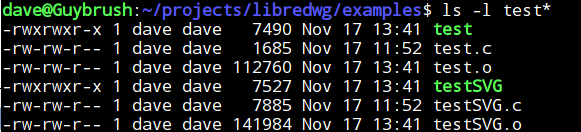

As can be shown by 'ls -l test*'
index.php/fa/12427/0/

Re: Debugging Existing Opensource Project [message #986463 is a reply to message #986050] Tue, 20 November 2012 09:26 Go to previous message
In Project Explorer click the small white triangle in the upper left corner to get the context menu. Then select "Customize View..". In the tab "Contents" enable "CDT Elements".
Usually this is enable by default.
