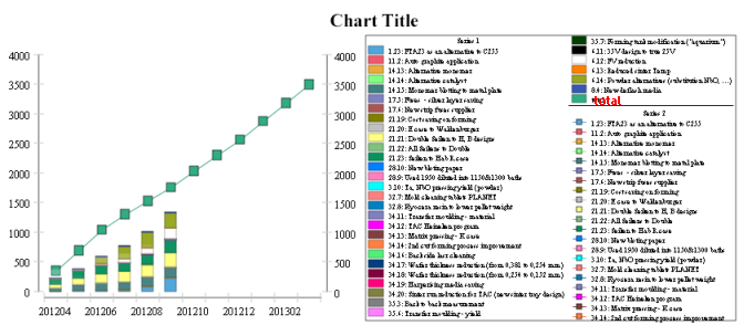

I have problem with same change of a legend entries. How can I reorganize entries - same way as series?
Picture show my problem if I use beforeDrawLegendItem and afterDrawLegendItem:
1) some of legend entries not in list (too much entries when doubled) = my line/total is not visible
2) after hiding entries there is unusual empty space
3) if legend entries ar organized in more columns I am lost with moving to right place
