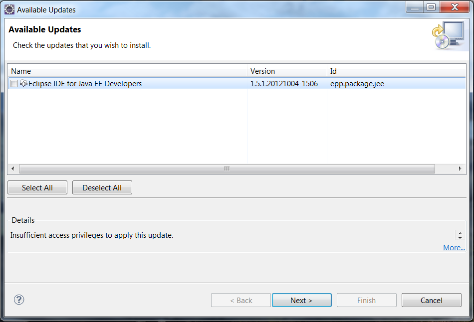

I am new to eclipse and is having some problems updating it. After configuring proxy settings (I am behind a corporate firewall) I got the update dialog to work. It found an updated Java EE IDE but I cant install it due to "Insufficient access privileges to apply this update" (see attached picture).

When I attempt to apply core updates to Eclipse Juno SR1, and by core, I mean "Eclipse IDE for Java Developers" (epp.package.java), I'm unable to place a check-mark next to the update and the message "Insufficient access privileges to apply this update" appears at the bottom of the dialog.
I suspect this is because I installed Eclipse to "C:\Program Files\eclipse", which is a privileged location on Windows. Changes to anything inside this directory require Administrator privileges. Presumably, Eclipse stores core updates in a subdirectory of "C:\Program Files\eclipse", but it stores plug-ins in a subdirectory of the user's home directory. This is why plug-ins can be installed without issue, but installing core updates fails.

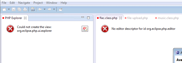

I've tried to work around this by launching Eclipse using "Run as Administrator". I'm able to install the updates, but the workspace goes to hell (see attached screenshot).
After I install the update, and I launch Eclipse under my own limited user account, the issue pictured in the attached screenshot persists. I have to re-install all of my plug-ins under my own account for them to begin functioning again.
