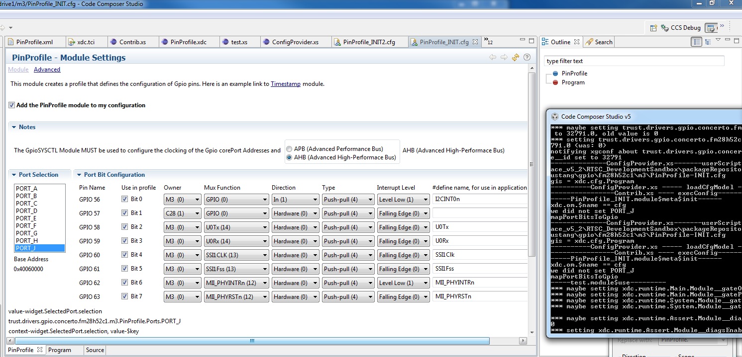

I have created a somewhat complicated form for setting pinmux settings. I have attached a screen shot to illustrate what I am doing.
In a listbox, I have a list of ports that can be selected. Each port bit has specific settings that can be selected from various droplist controls that give the allowable options. Since each port and bit have specific options, I have declared this in my .xdc file.

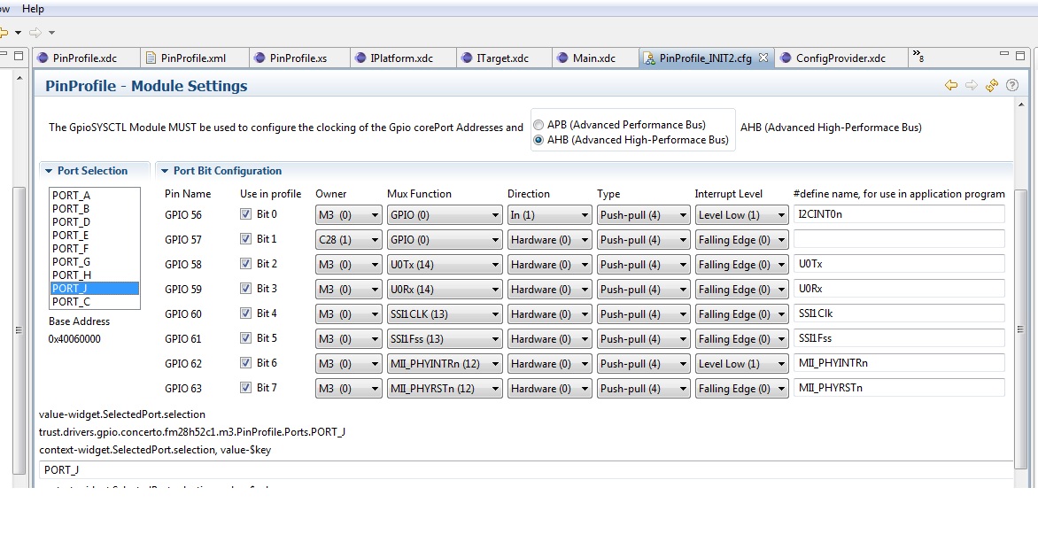

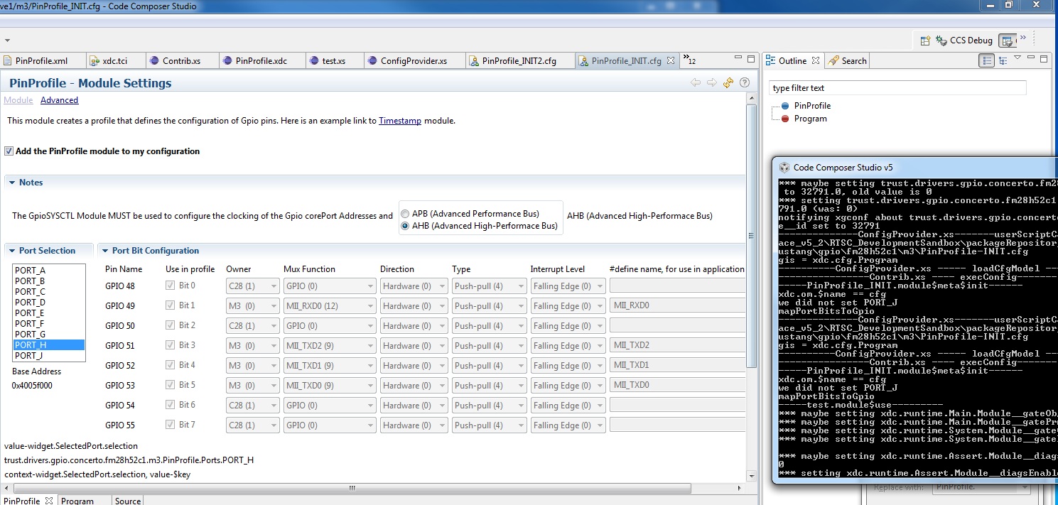

Notice that the statement of "PinProfile.Ports["PORT_J"] = null;" does NOT get executed because of (1==0). But it's presence DOES influence how my form behaves.
In the screenshot PORT_J, you can see that the form items are enabled. In the PORT_H screenshot (as well as all other ports), they are disabled.
You can also see in the screenshots the console screen that prints that PORT_J was not set.
What is different? My best guess is that the .cfg file is compiled, and so PinProfile.Ports["PORT_J"] is represented differently than all the other ports without literal strings, which causes the disabling of the form object.
