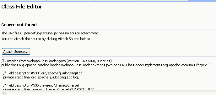

I have taken over an Eclipse project from a previous employee and attempting to create a walkthrough class to provide a "main" method so I can use breakpoints to step through the other classes and methods. Previously there was no "main" method because the project was accessd via a web service.
I have my "main" method set up and call to the first function coded and no red lines but when I attempt to instantiate the first object I am told "source not found". How do I rectify this please.

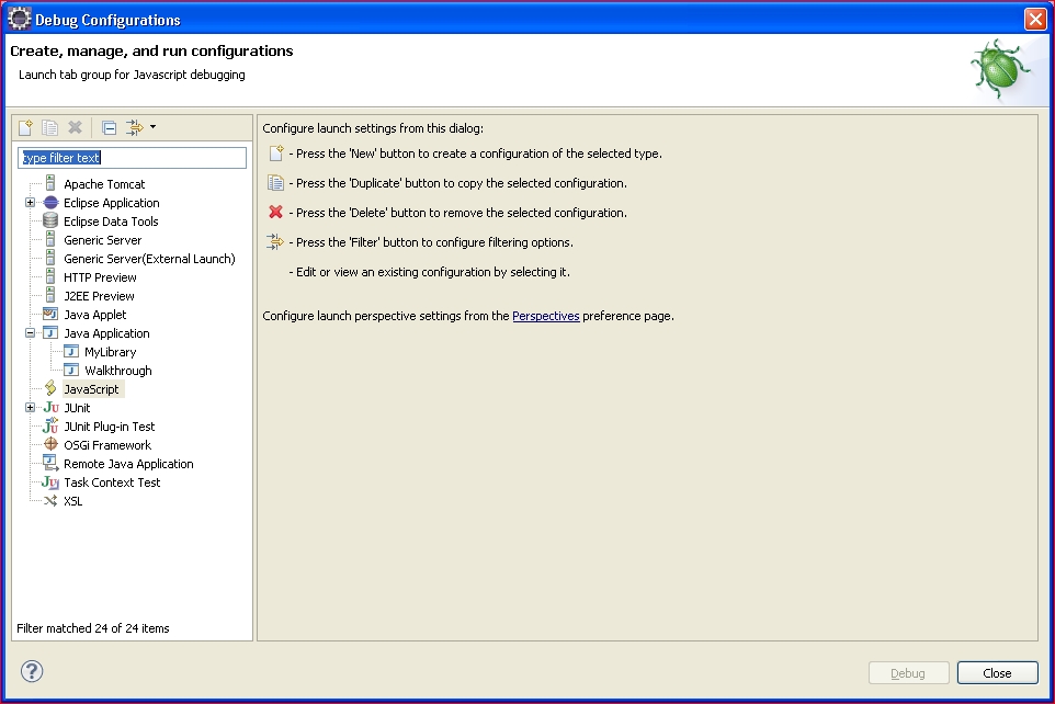

When you say "choose debug to launch the service", when I right click on the server I have set up I have no basic debug option I have "Debug as" awhich has a submenu of Debug Javascript and Debug configurations. Please find attached the screen dump of the configurations.
Although, when I right click on the actual project folder and this provides a Debug As with a sub menu that includes Debug on Server. However, when I selected this option I get the message of "Server Tomcat v7.0 Server at localhost failed to start."
(I ensured the ports the server is using are free ones). But I think this was because I was also running Tomcat locally outside Eclipse.
The next attempt it seemed to start but then provided a message stating;

Thanks again for all your help. I am getting somewhere now. At least slowly. I am managing to get the Tomcat server running within Eclipse and setting a break point and hitting the break point by running a call to the web service using SoapUI.
I can step through some code but always appear to eventually be told messages such as "source not found" or "class not found. Attach source". See attached image.
Can you advise on what best to do to be able to step through all the code without getting these messages.
Thanks again for your patience.
AJF
Re: Class not found [message #967390 is a reply to message #967344] Thu, 01 November 2012 14:28 Go to previous messageGo to next message
On 11/1/2012 11:48 AM, Alan Farroll wrote:
> Hi Russell,
> AJF
You're running into code that's in a JAR, in this case, the catalina
JAR, that you don't need to debug through (in particular, catalina is a
Tomcat thing). So, you'll be learning what's yours (and therefore what
you want to step through) versus what's not yours (and therefore what
you hope just works and don't have to worry about).
When you reach something that's in a third-party JAR, just step over it
either with F6 or by setting another breakpoint and continuing
(F8-Resume) to it.
