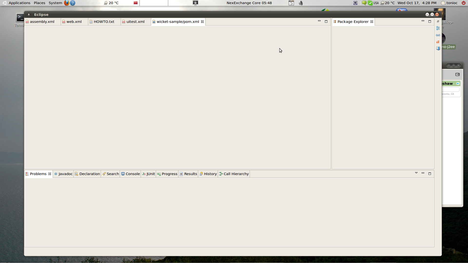

I updated my eclipse Juno version from 4.2.0 to 4.2.1 using Eclipse
update procedures (menus and so), and after restarting
nothing is working, I can see:
1 - My workspace layout as always
2 - All tabs in editors and views
3 - NO EDITORS
NO MAIN MENU
NO CONTENT IN ANY WINDOW
(Attaching a screenshot)
4 - No Exceptions
I've read around that this has to do with all plugins disabled after
this update, of course in my case I'm not able to use Eclipse
menus to take a look at it.
Eclipse in use: Eclipse J2EE amd64
Operating System: Ubuntu 10.04 64 (completely updated)
Java: oracle 1.6.37
Any ideas on how to solve the issue, any help will be greatly welcome
thanks

If seen other patterns of blank Eclipse 4.x but not the pattern shown in your screenshot.
Please file a bug against Platform/UI
Re: J2EE 4.2.1 from 4.2.0 update fail [message #949052 is a reply to message #948872] Thu, 18 October 2012 12:30 Go to previous message
thanks and bug filed #392358
