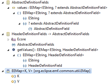

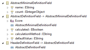

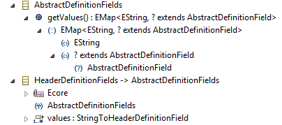

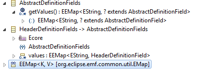

But I have a problem while implementing it with a Map.
index.php/fa/11810/0/
The picture shows my structure and my method definition.
The generated result is in class HeaderDefinitionFields:
EMap<String, HeaderDefinitionField> getValues();
and in class AbstractDefinitionFields:
Map<String, ? extends AbstractDefinitionField> getValues();
Why use EMF different maps?

> The generated result is in class HeaderDefinitionFields: EMap<String, HeaderDefinitionField> getValues(); and in class AbstractDefinitionFields: Map<String, ? extends AbstractDefinitionField> getValues();
The EMap data type is a wrapper for java.util.Map. You'd want a wrapper
data type for org.eclipse.emf.common.util.EMap (similar to EEList).
> StringToHeaderDefinitionField is a normal map integration like the one from the FAQ.
Thanks for your advice.
My first idea was to create a EDataType with org.eclipse.emf.common.util.EMap as instance class, but I don't know what to do with it.
My second approach was to use that class as instance from a EClass, but there are a lot of methods missing, I don't think that is the right way.
Perhaps I have missed something out.
I can't find the EEList Ecore definition otherwise I would look into it.
Please provide another hint. Smile

Okay I got it working so far I think, but I have to modificate a few lines of generated code.
Instead of
public EMap<String, HeaderDefinitionField> getValues()
I got following method
public EMap<String, ? extends AbstractDefinitionField> getValues()
. It is marked as error, because the system expect something else.
I can change it for my own and than it is okay, but I think there could a mistake in my ecore model.
I added the actual version:
index.php/fa/11816/0/
Re: Defining which derived class a feature from an abstract class shall use [message #940402 is a reply to message #940397] Thu, 11 October 2012 11:52 Go to previous messageGo to next message
Oh ... I made a mistake. I have now declared the method in AbstractDefinitionFields and the values feature in HeaderDefinitionFields and it works. Smile
Re: Defining which derived class a feature from an abstract class shall use [message #940434 is a reply to message #940402] Thu, 11 October 2012 12:28 Go to previous messageGo to next message

> I have added a picture of the class hierarchy which isn't serializable. The HeaderDefinitionFieldImpl seems to be unserializable.
What do you mean by that?
According to the exception, it seems that there is a problem with the HeaderDefintionField.
Re: Defining which derived class a feature from an abstract class shall use [message #941158 is a reply to message #941138] Fri, 12 October 2012 04:53 Go to previous messageGo to next message

Re: Defining which derived class a feature from an abstract class shall use [message #941203 is a reply to message #941188] Fri, 12 October 2012 05:43 Go to previous messageGo to next message
I am on the way to figure out, why I get a Java.io.NotSerializableException: HeaderDefinitionFieldImpl.
I have created a EDatatype with the instance class org.eclipse.emf.common.util.EMap, for the use of ? extends AbstractDefinitionField.
It fails while calling the method BasicEMap.writeObject(entry.getValue) on line 1530. Perhaps I shall use some other map implementation.
I adjusted the method createHeaderDefinition, that values get an instance of BasicEMap.
But I would say something is wrong with my HeaderDefinitionField in work with the BasicEMap.
StringToHeaderDefinitionField works without any problems, but with it I can't define the getValues EOperation like I have done it yet.
Re: Defining which derived class a feature from an abstract class shall use [message #941550 is a reply to message #941203] Fri, 12 October 2012 12:31 Go to previous messageGo to next message
John,
Comments below.
Yes, likely that should be marked as serializeable false because you
can't really convert such values to and from a string...
No, because you need EReferences to serialize references to EObjects.
No, I only told you do use this type of thing to define the type of an
operation, not the type of a feature.
Re: Defining which derived class a feature from an abstract class shall use [message #941777 is a reply to message #938932] Fri, 12 October 2012 17:19 Go to previous messageGo to next message
Thanks. I got it working. Smile

The method getDefinition is correctly generated like getDefition returns Y.
But there are two methods setDefinition one takes X and the other one takes Y.
Is it possibile to say that only setDefinition for Y shall be generated?
I hope there are enough information on the first try. Smile
Some pictures can be found in my post above (http://www.eclipse.org/forums/index.php/mv/msg/398079/940055/#msg_940055).
Re: Defining which derived class a feature from an abstract class shall use [message #942382 is a reply to message #942321] Sat, 13 October 2012 09:06 Go to previous message
John,
Comments below.
On 13/10/2012 1:52 PM, John M. wrote:
> There is only a little problem, but in this case with a single valued
> feature.
> I defined an abstract EClass containing two methods getDefinition
> returns X and setDefinition takes X.
> A derived EClass defines the feature definition from Type Y extends X.
> returns Y.
> takes Y.
No. This notion of covariant return types doesn't apply for arguments.
For arguments you are defining an overloaded method. If you really are
trying to match what's done for multi-valued, in that case you can't add
to the list, so for the single valued case you should not have a set method.
> I hope there are enough information on the first try. :)
