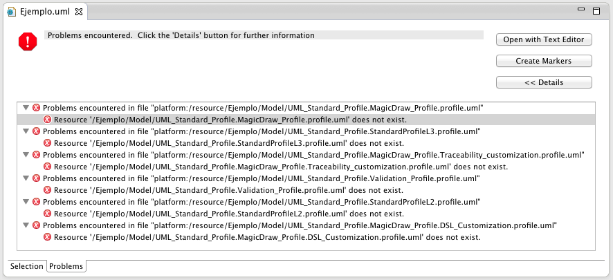

Re: Unable to run an EGL file based on a UML model [message #937748 is a reply to message #937737] Tue, 09 October 2012 04:20 Go to previous messageGo to next message
Hi Patricia,
The problem appears to be that the Ejemplo.uml refers to another Magic Draw profile UML model (see attached screenshot) which does not exist.
Cheers,
Dimitris

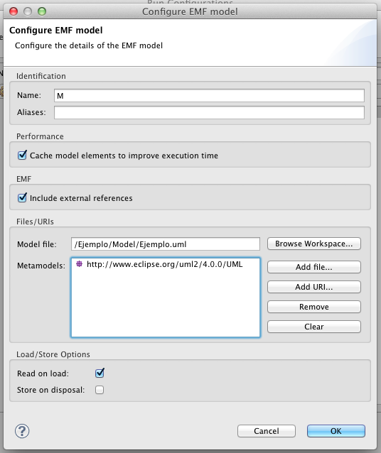

Re: Unable to run an EGL file based on a UML model [message #937776 is a reply to message #937759] Tue, 09 October 2012 04:47 Go to previous messageGo to next message
Hi Patricia,
Thanks. In the model configuration dialog, you'll need to keep only the main UML metamodel URI (see attached screenshot) and then it should work.
Cheers,
Dimitris
Re: Unable to run an EGL file based on a UML model [message #937780 is a reply to message #937776] Tue, 09 October 2012 04:51 Go to previous message
Dimitris Kolovos wrote on Tue, 09 October 2012 04:47
Hi Patricia,
Cheers,
Dimitris
Hi Dimistris,
Thank you so much. Problem solved!
