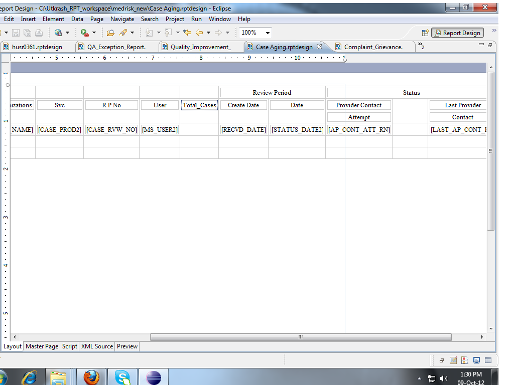

Re: Use Multiple Dataset For One Table [message #937730 is a reply to message #937334] Tue, 09 October 2012 04:06 Go to previous messageGo to next message
I want total_user(actually it is total_cases) in Parallel of other Columns...pl look Screenshot.total_case in Screenshot.I have to count cases for Each User.other columns from query1.
