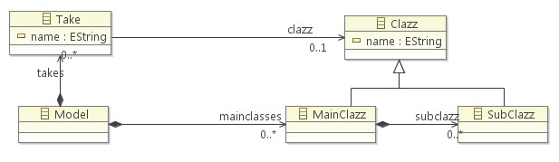

Hello all
Given the following language definition (simplified to cover the problem ;-):
Model:
	mainclasses+=MainClazz*
	takes+=Take*
Clazz:
	MainClazz|SubClazz;
MainClazz:
	'main' name=ID
	'subclasses' subclazz+=SubClazz* '.'
SubClazz:
	name=ID
Take:
	'take' name=ID
	'Class' clazz=[Clazz]
So in this constellation, I only have access with the generated DSL to the instances of "MainClazz" in Take.clazz. However, if I have a look at the generated ecore model, it seems to me as I would have the possibility of referencing all instances of SubClazz and MainClazz with the superclass Clazz in the attribute Take.clazz (as I would expect).
index.php/fa/11712/0/
Is there a way to get all instances of Clazz availabe for Take.clazz? Is this in context with the scoping feature of xtext? Or should I do it completely different?
Thanks for any help or clarification.
Andreas
  • Attachment: Clazzes.jpg
    (Size: 16.11KB, Downloaded 367 times)
Re: Scoping Question (Beginner) [message #932075 is a reply to message #932066] Wed, 03 October 2012 16:15 Go to previous messageGo to next message
clazz=[Clazz|FQN]
FQN: ID ("." ID)*;
should do the trick
Re: Scoping Question (Beginner) [message #934232 is a reply to message #932075] Fri, 05 October 2012 15:33 Go to previous messageGo to next message
Hello Christian
Thanks. That was really the trick.
However, I don't understand exactly why this works, but it does...
(it seems to me like a "...and here some magic happens" solution Wink )
Andreas
Re: Scoping Question (Beginner) [message #934236 is a reply to message #934232] Fri, 05 October 2012 15:36 Go to previous message
clazz=[Clazz] us short for clazz=[Clazz|ID]
which means "ref to a Clazz and therefore parse an ID"
Names a by default built hierachically
=> parentname.childname
an id does not allow a dot
=> you get only clazzes with a name without dot => parents
