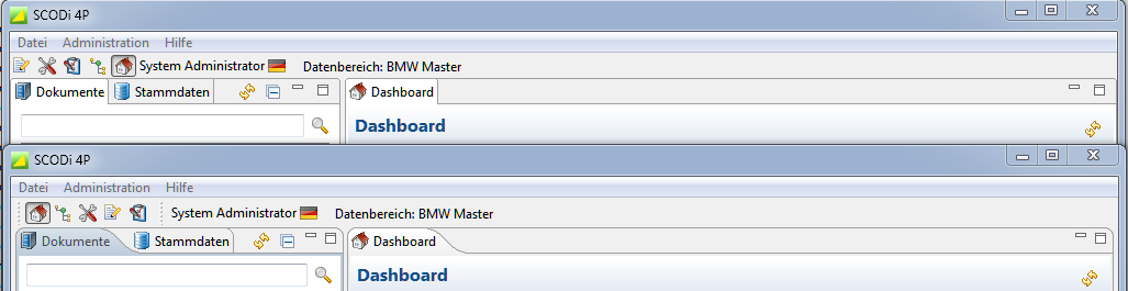

I'm migrating our application from eclipse 3.7.2 to 4.2.1.
After I changed my target definition and started our application, the editor and view tabs are no longer rounded but square. See attachment...
Any Idea on how to change them back to normal?

Re: Rounded Tabs [message #929569 is a reply to message #929544] Mon, 01 October 2012 11:16 Go to previous messageGo to next message
Your product or application is probably not providing any CSS themes. See eclipse/plugins/org.eclipse.platform_4.2.1.v201209141800/css for the ones we use in the IDE.

Re: Rounded Tabs [message #929684 is a reply to message #929569] Mon, 01 October 2012 13:07 Go to previous messageGo to next message
Hi Paul
Thank's for your reply. I added a CSS using this tutorial:
http://www.vogella.com/articles/Eclipse4CSS/article.html
I now have rounded tabs.
