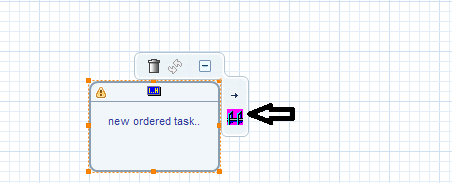

I have a "Task node A" (graphical node in graphiti) with a "Context button". The context button is in tended to create a new "Task node B" and a link connting from A to B.
"Task node A" and context button is shown in the figure below.
index.php/fa/11676/0/

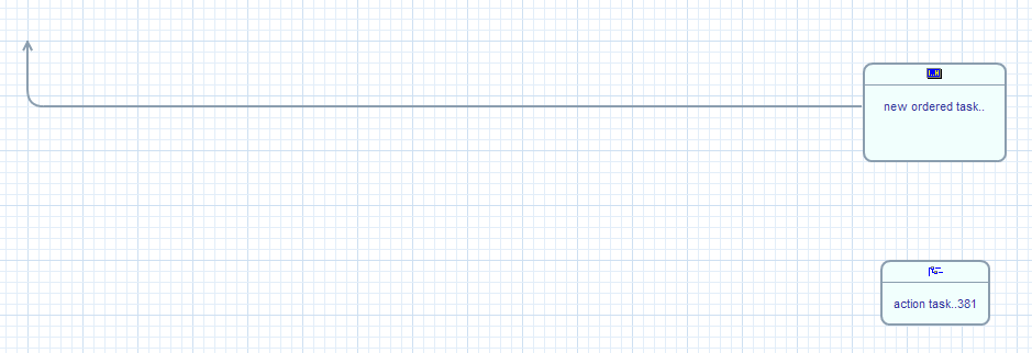

When I drag starting from context button and drop on the canvas editor, I get the new task created but the "link" is not created as expected as you can see in the following diagram. The link unexpectedly ends up towards the left top corner of the editor.
index.php/fa/11677/0/
