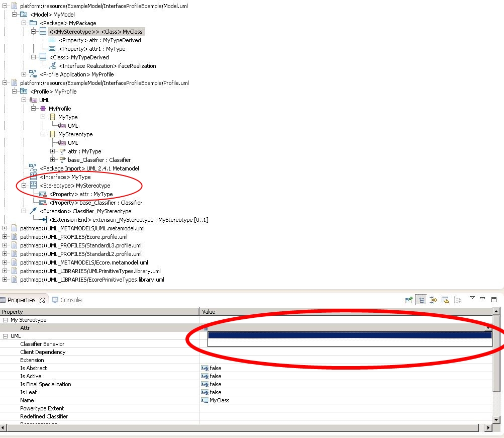

I attach an example, I hope that it explains better then me Razz
As you can see I can't choice element for the required attribute of the Stereotype applied. I tried to create a class (MyTypeDerived) that implements the interface specified into the Profile and even two properties (one of type MyType and other of type MyTypeDerived) into the stereotyped class, but it didn't work.
Thanks for replying,
m

Re: setValue() of a stereotype attribute of custom type [message #933811 is a reply to message #933782] Fri, 05 October 2012 07:13 Go to previous messageGo to next message
You're right, here are the .uml files
Anyway I don't follow you about instance... What do I wrong? Isn't a property enough?

Re: setValue() of a stereotype attribute of custom type [message #934795 is a reply to message #933811] Sat, 06 October 2012 05:53 Go to previous messageGo to next message
Ok. I can see the models now. They look ok.
The two blank lines in your PNG look unhelpful but not wrong.
What is it that you cannot do?
Ed Willink

Re: setValue() of a stereotype attribute of custom type [message #937738 is a reply to message #934795] Tue, 09 October 2012 04:11 Go to previous messageGo to next message
I cannot assign a value to the 'Attr', the two blank lines aren't selectable.
I also tried programmatically with uml2 API, as I described in the first post, and I get the same problem.
[Updated on: Tue, 09 October 2012 04:12] by Moderator

Re: setValue() of a stereotype attribute of custom type [message #939133 is a reply to message #933811] Wed, 10 October 2012 09:05 Go to previous message
Hi, Mauro,
I see in the profile that the 'attr' property of type MyType is not a
composite aggregation, which in Ecore terms is a containment reference.
So, in Ecore terms, an instance of MyStereotype has a cross-reference
named 'attr' to an instance of MyType.
The editor requires you to have an instance of MyType available to
assign to the 'attr' reference. That's why the Properties view
provides a drop-down list to pick from. The problem that you have is
that there isn't any place to create an instance of MyType because
* there is no containment reference of type MyType or some concrete
subtype of it
that can hold a MyType instance
* there is no concrete subtype of the MyType interface in the
profile, so you wouldn't
be able to create any instances of it, anyways
HTH,
Christian
> property enough?
> <image><image>
