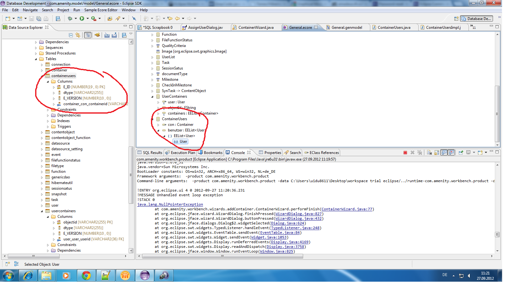

I'm using Teneo/Hibernate to map my data model to a Oracle database,
within the model I have a many-to-many relation, according to this http://wiki.eclipse.org/Teneo/Hibernate/ModelRelational/Association_Mapping
hibernate cannot handle nm relations therefor I have to separate them into two tables and use Elist (org.eclipse.emf.common.util.EList). Now my problem is in persisting the entities in the Elist. It seems that the mapping didn't really map the Elist. Thats why when I try to insert a value then to to get it later on it gives me null as a result.
here is a photo to explain what I mean:
Can anyone please let me know where can I refer to regarding the Elists and how to use then properly?
Thank You
  • Attachment: Untitled.png
    (Size: 267.14KB, Downloaded 153 times)

Hi Zainab,
Hibernate can handle nm associations. The wiki page you refer to discusses this, it needs join tables that's all. But
this is done automatically by Teneo.
I think you create an EAttribute but you should create an EReference with upperbound -1 on both sides of the association
and as an etype use your own eclass (User) and not EEList. So it is not necessary to use EEList in your ecore file directly.
Teneo will automatically take care of creating join tables etc.
See also this page for related options:
http://wiki.eclipse.org/Teneo/Hibernate/Configuration_Options
gr. Martin

Re: Hibernate EList [message #925022 is a reply to message #925004] Thu, 27 September 2012 06:14 Go to previous messageGo to next message
Thank You martin for your reply but I need the entity to be a list of users, not only one. So that I can associate multiple users for every container. that's why I created two join tables 1 container : n users and the other table 1 user : n containers
and users in the first table and containers in the second table are stored in Elist.

Hi Zainab,
Yes but if you set the upperbound of the ereference to -1 then you will get an elist in java and you can add multiple
users. Have you checked the standard emf library example, it has a number of examples of this.
gr. Martin
