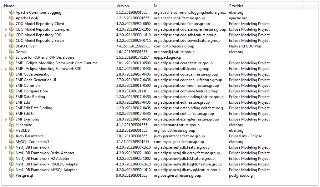

Re: [CDO] Multi master (clone) [message #929149 is a reply to message #926998] Mon, 01 October 2012 05:00 Go to previous messageGo to next message
I've tried it in both mysql and h2.. still no luck. I now installed cdo 4.2.0, but this has the same results. I added a picture of my installed software, maybe you see a wrong version number here..
Installed software:
index.php/fa/11672/0/
Re: [CDO] Multi master (clone) [message #929180 is a reply to message #929149] Mon, 01 October 2012 05:22 Go to previous messageGo to next message
Am 01.10.2012 11:00, schrieb Ricky de Klerck:
Looks like yesterday's I-build and that should be okay. I'm not sure about the "Eclipse for RCP and RAP Developers
1.5.1", though. Have you tried with a normal (classic) SDK?
Cheers
/Eike
http://www.esc-net.de

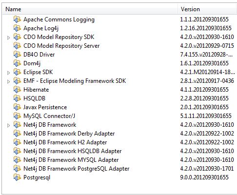

Re: [CDO] Multi master (clone) [message #929223 is a reply to message #929180] Mon, 01 October 2012 05:53 Go to previous messageGo to next message
Installed eclipse classic and necessary plugin but still no luck.
index.php/fa/11673/0/
Did you also tried it with the client and checked the result or only with the testcase?
Re: [CDO] Multi master (clone) [message #929230 is a reply to message #929223] Mon, 01 October 2012 05:55 Go to previous messageGo to next message
Am 01.10.2012 11:53, schrieb Ricky de Klerck:
Both. And in both branches.
Cheers
/Eike
