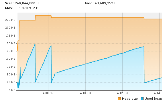

When my editor (that uses epsilon for EVL and EGL) is sitting idly (no models are opened), I have problems with my heap getting larger and larger until the GC kicks in to reduce it. This results in a saw-tooth shape when using VisualVM to analyze the problem. (See attachment)
When I disable (paused thread by placing a breakpoint) that runs PeriodicallyUpdateEPackageRegistryMonitorJob the heap does increase at a much lower pace (see attachment were the saw-tooth slope is less steep).

  • Attachment: heap.png
    (Size: 19.50KB, Downloaded 211 times)

So just setting a breakpoint in the Job is not a good way to check if it is the cause of the massive heap usage? (Note that Eclispe and my editor are still properly working when I used the breakpoint)
