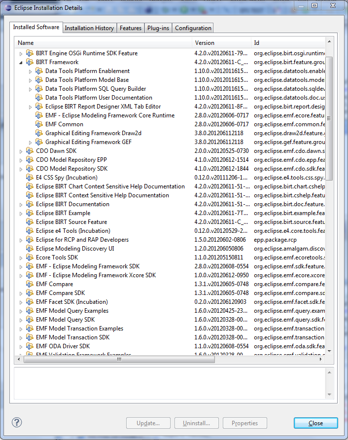

Re: Integrated BIRT Report giving OCL errors [message #919032 is a reply to message #919021] Fri, 21 September 2012 12:07 Go to previous messageGo to next message
Jason,
The application is an SWT app, so it's short. There are two classes, one for the UI getting the input/output and data source file names plus the output format, and the other class which is what I posted, the BirtReportRunner. I have the DOC, HTML, XLS, and PDF emitters working correctly I believe, but the OCL query error is stopping the results.
I am using Juno. I attached a screen shot of the software installed. Looks like 4.2 of BIRT, and 1.1.0 of EMF ODA driver.
Thanks for your time,
Randy
