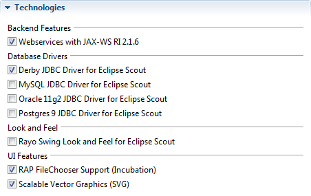

For RAP UI, you need to enable the FileChooser explicitly by following these steps:
1. Switch to Scout Perspective
2. Select your Scout project (e.g. org.example.logo)
3. In Scout Object Properties view, choose RAP FileChooser Support (Incubation) under UI Features
index.php/fa/11509/0/
Stephan

Re: File Chooser and Upload for RAP UI [message #1005897 is a reply to message #915492] Tue, 29 January 2013 04:02 Go to previous messageGo to next message
In my project I only see the "SVG" option but not the "Incubation" support. Is there an explanation on how to make those changes manually somewhere?
Re: File Chooser and Upload for RAP UI [message #1006062 is a reply to message #1005897] Tue, 29 January 2013 11:53 Go to previous message
I solved my problem by installing the missing RAP SDK in my eclipse. The FileChooserField in forms works now nicely in RAP. Using a FileChooser instance directly in the following way does not work, however:
