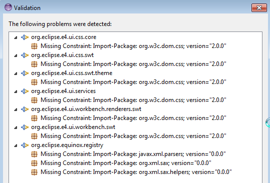

Now I tried the latest you suggested:
Eclipse e4 Tools (Incubation) 0.12.0.v20120910-1918
from
http://build.eclipse.org/eclipse/e4/build/e4/downloads/drops/4.0.0/I20120911-1511/repository/
and other dependences are missing, see image
index.php/fa/11501/0/

!SUBENTRY 2 org.eclipse.e4.ui.workbench.renderers.swt 2 0 2012-09-16 23:59:34.928
!MESSAGE Missing required bundle org.eclipse.e4.ui.workbench.swt_0.9.0.
!MESSAGE Missing required bundle org.eclipse.e4.ui.css.swt.theme_0.9.0.
!MESSAGE Missing required bundle org.eclipse.e4.ui.css.core_0.9.0.
!SUBENTRY 1 org.eclipse.osgi 2 0 2012-09-16 23:59:34.928
!MESSAGE Bundle com.rcpvision.e4_1.0.0.qualifier [19] was not resolved.
!SUBENTRY 2 com.rcpvision.e4 2 0 2012-09-16 23:59:34.928
!MESSAGE Missing required bundle org.eclipse.e4.ui.workbench.swt_0.10.1.
!MESSAGE Missing required bundle org.eclipse.e4.ui.css.core_0.10.1.
!MESSAGE Bundle org.eclipse.e4.ui.css.core_0.10.1.v20120523-1955 [20] was not resolved.
!SUBENTRY 2 org.eclipse.e4.ui.css.core 2 0 2012-09-16 23:59:34.928
!MESSAGE Missing required bundle org.apache.batik.css_[1.6.0,1.7.0).
!MESSAGE Bundle org.w3c.dom.svg_1.1.0.v201011041433 [26] was not resolved.
!SUBENTRY 2 org.w3c.dom.svg 2 0 2012-09-16 23:59:34.928
!MESSAGE Missing required bundle org.w3c.dom.smil_[1.0.0,1.1.0).
!MESSAGE Missing required capability Require-Capability: osgi.ee; filter="(|(&(osgi.ee=JavaSE)(version=1.4))(&(osgi.ee=JavaSE)(version=1.3))(&(osgi.ee=CDC/Foundation)(version=1.0)))".
!MESSAGE Bundle org.w3c.dom.smil_1.0.1.v200903091627 [32] was not resolved.
!SUBENTRY 2 org.w3c.dom.smil 2 0 2012-09-16 23:59:34.928
!MESSAGE Missing imported package org.w3c.dom.events_[3.0.0,4.0.0).
!MESSAGE Bundle org.eclipse.e4.ui.css.swt_0.10.1.v20120523-1955 [51] was not resolved.
!SUBENTRY 2 org.eclipse.e4.ui.css.swt 2 0 2012-09-16 23:59:34.928
!MESSAGE Bundle org.eclipse.e4.ui.workbench.swt_0.10.1.v20120525-2014 [57] was not resolved.
!SUBENTRY 2 org.eclipse.e4.ui.workbench.swt 2 0 2012-09-16 23:59:34.928
!MESSAGE Missing required bundle org.eclipse.e4.ui.css.swt_0.9.0.
!MESSAGE Missing imported package org.apache.batik.css.engine_1.6.0.

Re: Wizard "Eclipse 4 Application Project" misses to add "org.w3c.dom.events" pl [message #915240 is a reply to message #915238] Sun, 16 September 2012 18:23 Go to previous messageGo to next message
@Vincenzo - Try downloading the Eclipse RCP and RAP package, your modeling IDE target seems to be missing required plug-ins.
Re: Wizard "Eclipse 4 Application Project" misses to add "org.w3c.dom.events" pl [message #915250 is a reply to message #915240] Sun, 16 September 2012 19:06 Go to previous messageGo to next message
Or just the SDK (classic) distribution.
However I'll download tomorrow the Modelling package and try to reproduce this.
Re: Wizard "Eclipse 4 Application Project" misses to add "org.w3c.dom.events" pl [message #915252 is a reply to message #915240] Sun, 16 September 2012 19:10 Go to previous messageGo to next message
@Lars: thank you, your tips are always great! With that version it works!
Just a note: I see some errors in the Error Log view ("Unhandled event loop exception" 3 times) which do not appear with Eclipse Modeling Tool package.
However please note that the plug-in required (org.w3c.dom.events) is indeed included in Eclipse Modeling Tool package; in fact just fixing the launch solves the problem.
Shouldn't this however be considered a bug for the "Eclipse Modeling Tool" package?
