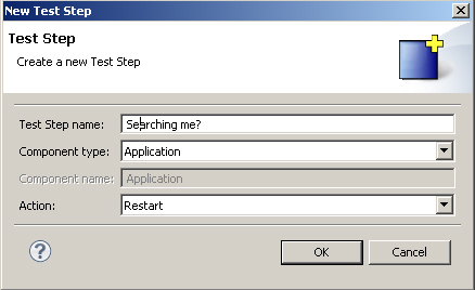

I never tried it, but i think the teststep Application -> Restart should do that job.
Helpful information from http://help.eclipse.org/indigo/index.jsp?topic=%2Forg.eclipse.jubula.client.ua.help%2Fhtml%2Freference%2Fnode13.html
Restart (Application)
Use this action to restart the AUT during the test.
The action closes your AUT and all windows/dialogs associated with it.
It then starts the same AUT with the same configuration as it had when you originally started it and carries on with the test.
If your AUT takes a while to load/to be ready, it is a good idea to use the "wait for window" or "wait for component" action after the restart action.
\includegraphics[height=2cm]{danger} Do not use the restart action as the first Test Step in a test.
This action has no parameters.
  • Attachment: this.jpg
    (Size: 50.18KB, Downloaded 209 times)
Re: How to start AUT between the test cases automaticlly [message #937633 is a reply to message #912788] Tue, 09 October 2012 02:02 Go to previous message
Great Thanks.
It works!
The restart function include two operations: Shutdown the AUT firstly, then Restart the same AUT. So if I want to use the restart function, I should keep the AUT alive.
