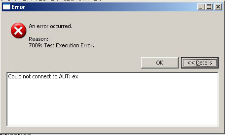

Edit #2: Ok i was able to reproduce the Problem with the GFExplorer and on GUI. Here are the steps:
0. Create some Oracle DB, New Project/Use existing project for that (you already have this)
1. Test -> Properties -> New AUT ->
2. Name it "ex" -> Toolkit RCP -> Add Aut Conf
3. (Basic) -> Host: Add host with your (local) IP, select it (not localhost!)
4. Select GFEExplorer in Examples
5. Create a simple Testcase named "activateEx", just put one Application -> Activate Step into it, Put this Testcase activateEx into a Test suite, choose the ex-application as application in the Properties.
6. Start AUT-Agent from /server (on the IP you just added)
7. Now go to Host #2, start Jubula, load project, connect to the non-local AUT Agent, start ex-aut. Now the GFEExample should start up at Host #1.
8. Start "ActivateEx" from the Test Suite Browser (on Host #2)
9. This error Window, no test is executed.
index.php/fa/11439/0/
(10. Disconnect Aut Agent, try Step 7 + 8 on Host #1 - it works. So some kind of your connection is going local instead of over the network.)
It's the same error as described in the first part, that you can start the AUT but no concrete Test Suite, because the AUT can't be found if it's remote.
