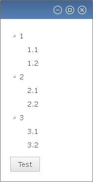

The tree viewer starts with the following contents:
index.php/fa/11398/0/

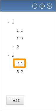

Afterwards, when 'Test' is pressed, node '2' is moved below node '1' and treeviewer.refresh() is called.
This leads to the following representation:
index.php/fa/11399/0/
As can be seen, node '3' now contains the wrong child '2.1' which actually belongs to node '2'.
I've debugged this some time ago and I've seen that the underlying TreeItems really contain the wrong elements after some stage in the refresh process.
I would be glad if you could help me, since many of our tree viewers are based on ILazyTreeContentProvider's.
Ken

I tested it against RAP 2.0M1 and SWT. Seems fine in SWT, while items
indeed contain the wrong text in RAP. It's not a rendering glitch
either, rather a bug in the RAP JFace implementation. Could you open a
bugzilla entry for this issue?

Thank you for investigating this.
I've opened a bugzilla entry:
https://bugs.eclipse.org/bugs/show_bug.cgi?id=388950
Ken
