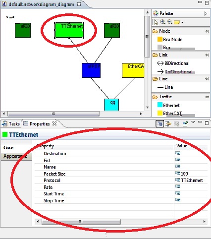

As u can see there are several nodes in the diagram. When i select a node the property of the particular node is shown under Properties menu.
What i want to do....when i double click the node a popup window will appear containing the properties.then i give some value and save it.
is any1 can help me out?

did you try to install the OpenEditPolicy into the Editpart (http://publib.boulder.ibm.com/infocenter/rsmhelp/v7r0m0/index.jsp?topic=/org.eclipse.gmf.doc/reference/api/runtime/org/eclipse/gmf/runtime/diagram/ui/editpolicies/OpenEditPolicy.html). This should handle double click.

your editparts do have a method createDefaultEditPolicies there you can install it. You should consider customizing the templates or using extension points to get this done.
