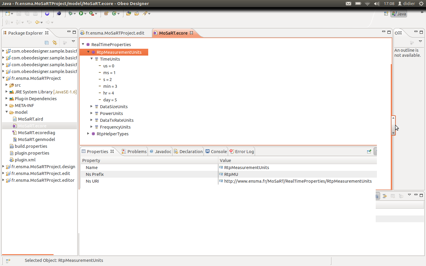

For the second one, EMF doesn't generate the ***.util because in the ecore model, this package is only composed of enumeration types, as you can see in my attachment.
index.php/fa/11379/0/
If I want to use EEF, do I have to change my model, by defining my enumeration type apart, and to define attributes which are instance of one of my enumeration type. Or is it posible to keep my ecore model as it is now.
And for the third error, I think that it was link to one of the other error, but in fact, I'm not working alone on that project, and this error is not due to my work, but to something uncomplete. Sorry.

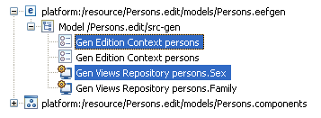

While I was working with this example, I have seen that I just have to modify the ***.eefgen file, which concern the package which contain enumeration. For example in the previous model:
index.php/fa/11402/0/
Thanks for your answer Goulwen.

Sorry for the last unclear message,
In fact, I have deleted the two highlighted file on the previous picture, so the problematic code is'nt generated anymore and everything is fine with it.
Aurélien
