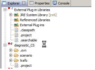

I reuse the JDT Package Explorer in my RPC app but some decorators are missing. Pls see the screenshot. I think that some bundles are missing with the required images but don't know how to know wich ones.
To embed the JDT Package explorer I have declared the following extension:
<view
category="fr.irit.IFclipse.view"
class="org.eclipse.jdt.internal.ui.packageview.PackageExplorerPart"
icon="icons/filenav_nav.gif"
id="fr.irit.ifclipse.views.projectExplorerView"
name="Explorer"
restorable="true">
</view>
</extension>
By the way I don't find using "*.internal.*" packages very comforting, I'm wrong ?

If the JDT bundles are loaded at runtime, their manifests should be read (eg their extension points). Instead of creating your own view, just use the existing Package Explorer view in your perspective factory.
Are you sure you want to be using the package explorer and not the common navigator?
Common Navigator Framework
JD

Thank you for the CNF link. Now I have reused the Project Explorer :
      <view
            class="org.eclipse.ui.navigator.resources.ProjectExplorer"
            name="Explorer"
            restorable="true">
      </view>
But the label decorators are still missing.
The icon also is missing.
