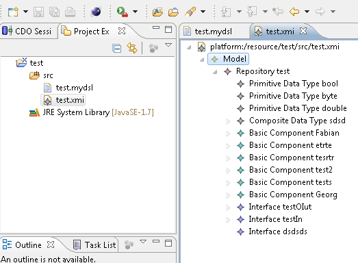

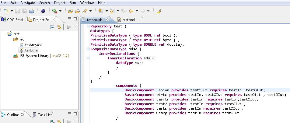

Re: Can i get an XMI model from a DSL textual file? [message #903764 is a reply to message #903762] Sat, 25 August 2012 11:49 Go to previous messageGo to next message
Hi Christian,
Please have a look at the attached picture...
I mean the following:
As you see in the mydsl.png picture We have a normal xtext editor test.mydsl (which we can define components and interfaces and so on)....
Now what I want is to generate an model file out of it: test.xmi (look xmi.png)....
And I want both of them to be syncronized, which means for example:
If I define a new component in test.mydsl, then this component to appear automatically in test.xmi....Or the opposite if I define a new component in test.xmi to be automatically in test.mydsl....
Cheers
Georg
  • Attachment: mydsl.png
    (Size: 27.69KB, Downloaded 243 times)
  • Attachment: xmi.png
    (Size: 21.26KB, Downloaded 1029 times)
