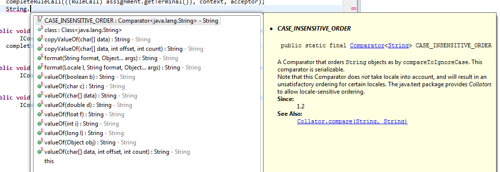

Is it possible to display some sort of documentation while displaying the content assist like java does it? Currently I only know how to display tooltips. But one first has to select an item from the content assist to be able to see the tooltip containing the documentation.
I've found a tutorial about the eObjectDocumentationProvider but that doesn't display while content assist is active...
