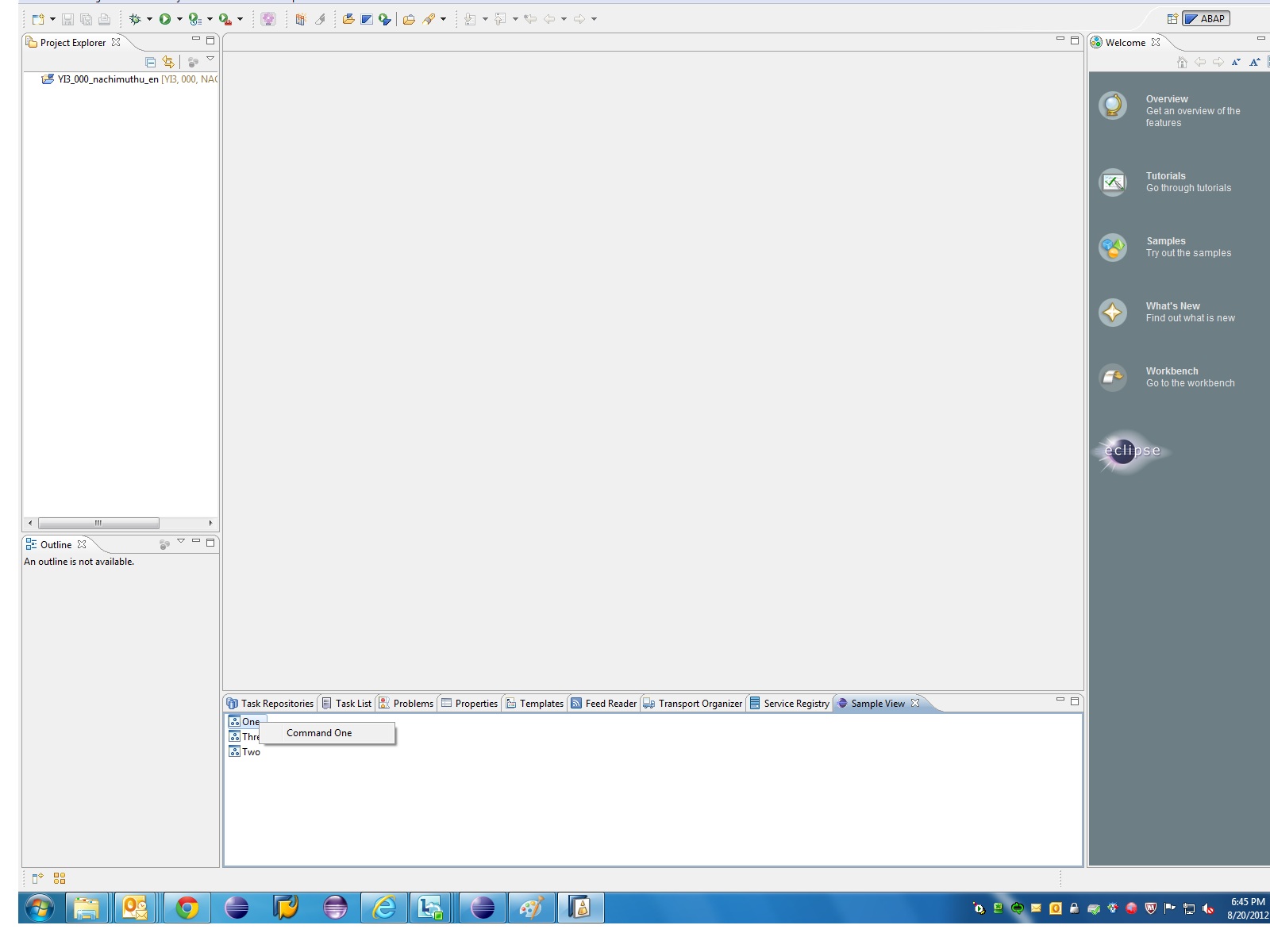

I am creating a dynamic context menu using dynamic menu contributor. But I have a property tester to determine whether to contribute these items or not. I am using this property tester inside visibleWhen condition.
It is working perfectly in Eclipse 3.x but not in 4.2. Find the attached sample plugin with a Simple View to re-produce the issue.
In the sample application, Dynamic Items will be visible only if you select node 'Three'. But in 4.2, dynamic items are visible always.
