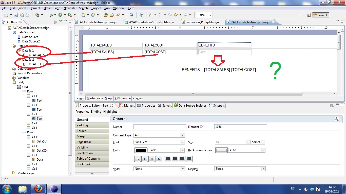

I have a question.
I have two databases one is access and other is MySql. I use information in tables and grid for each of these tables and using differents datasets, but when i want to create a DATA Cell with a result from 2 datasets from i have a problem, I don't know what can i do?.
My case is:
DataSet1 = Only it has a row with a number. TOTALSALES = 1112
DataSet2 = Only it has a row with a numbre. TOTALCOST = 345
I want show the value --> TOTALSALES - TOTALCOST in a grid, but i don't know if this is possible or impossible. The DATA CELL i would like to name = BENEFITS
BENEFITS = DataSet1.TOTALSALES - DataSet2.TOTALCOST
BENEFITS = 1112 - 345 = 767
Thanks.
