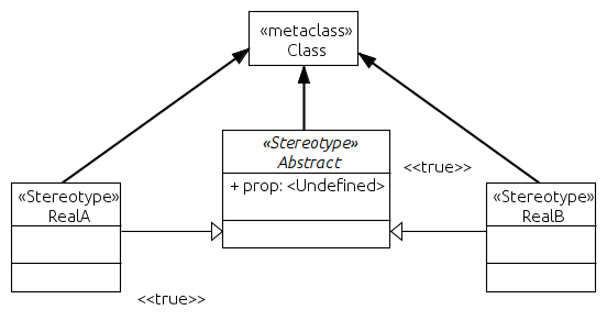

Dear all,
I'm trying to use inheritance in a profile, two stereotypes share a number of properties and hence I created an abstract steretype which they generalise. The picture attached shows this scheme.
index.php/fa/11221/0/TestProfile.PNG
I can apply these stereotypes in a class diagram, but I can't set the value of the properties. When I click in the expand triangle besides the stereotype in the Properties view I get the exceptions below and no properties are ever presented. I'm also unable to save a diagram where one of these stereotypes are used.
Is this schema compliant with the standard? (I believe so) Or should stereotype generalisation be declared a different way?
Thank you for reading.

I'm pretty sure the problem is related to your property "prop", which is not typed. This is invalid. Papyrus should forbid applying an invalid profile, but currently it does not, which sometimes leads to model corruption.
