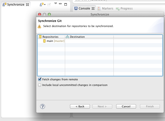

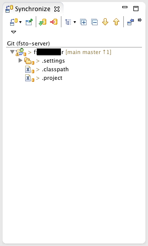

In the Synchronize View I setup to sync my project with Git but if I close Eclipse I lose this setup. See attached screen shots. Is there at way to keep my sync configuration between Eclipse restarts?
