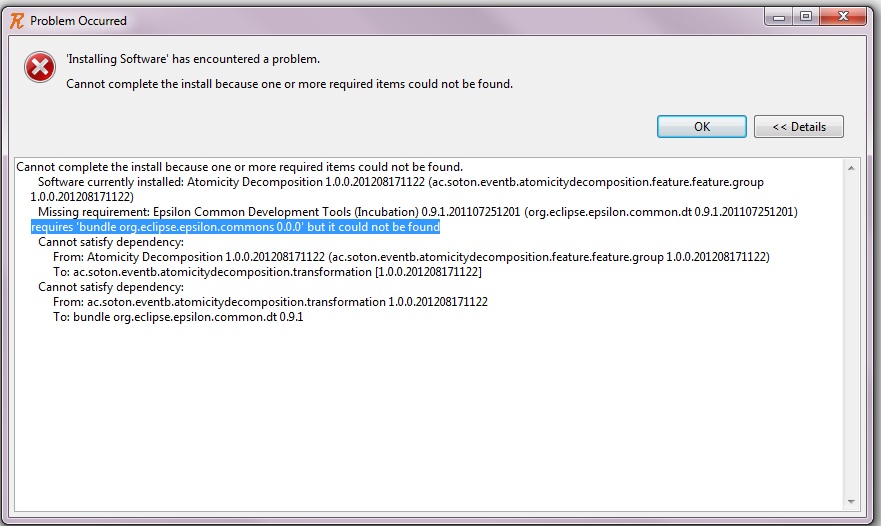

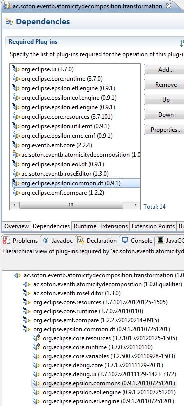

I am a Rodin developer at University of Southampton, working with Michael Butler. I am trying to release my plug-in integrated into Rodin, but I have a problem with Epsilon installation.
My plug-in is depend on the "org.eclipse.epsilon.common.dt"
and this plug-in is dependent on the "org.eclipse.epsilon.commons"
index.php/fa/11208/0/
I expect the later plug-in to be installed automatically when I am trying to install my plug-in, but it is not and an error occurs.
index.php/fa/11209/0/
Can you please help me ?

Hi Asieh,
Have you installed Epsilon in the environment where you are deploying your plugin or are you exporting/packaging some of the epsilon plugins with your distribution? In the first case the "org.eclipse.epsilon.commons" should be in your environment and as Dimitris pointed out a reproducible list of steps will help. If the case is the latter, you also have to export/package the "org.eclipse.epsilon.commons" with your distribution, as the dependency is only a requirement and is not used to export/pack additional dependencies when building.
