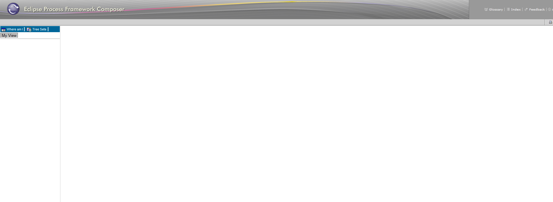

Hi, I'm currently working on a simple method plug-in. In the custom categories, I defined a view and added some content elements. When I publish the method plug-in, everything works fine (no errors or warnings).
What bothers me is that I always first see a blank page. Please see the attached screenshot. Only if I click on "My View", the content and the menu appear.
I couldn't find any useful option to set the default page when opening from the Publishing Options page. Any help is welcome. Thanks.

Did you set the My View as the default view for the configuration? It is an option on the View page of the Configuration setup.

hi Flavelle, yes, I checked that My View is set as the default view for the custom configuration. The most weird thing is that I have to click on it once to make all the contents visible in the published page...

I think this has nothing to do with my method plugin or configuration. Until now, I used Chrome to view the published website.
I just opened it in Internet Explorer 9 and I first got the warning that some contents were blocked. After clicking on "Allow blocked contents" in IE, the published website appears and the contents are visible. Google Chrome does not say anything about some blocked contents but doesn't show the page correctly.
In the Opera browser the EPF published website does not work at all...
