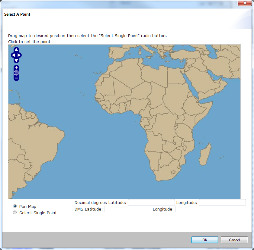

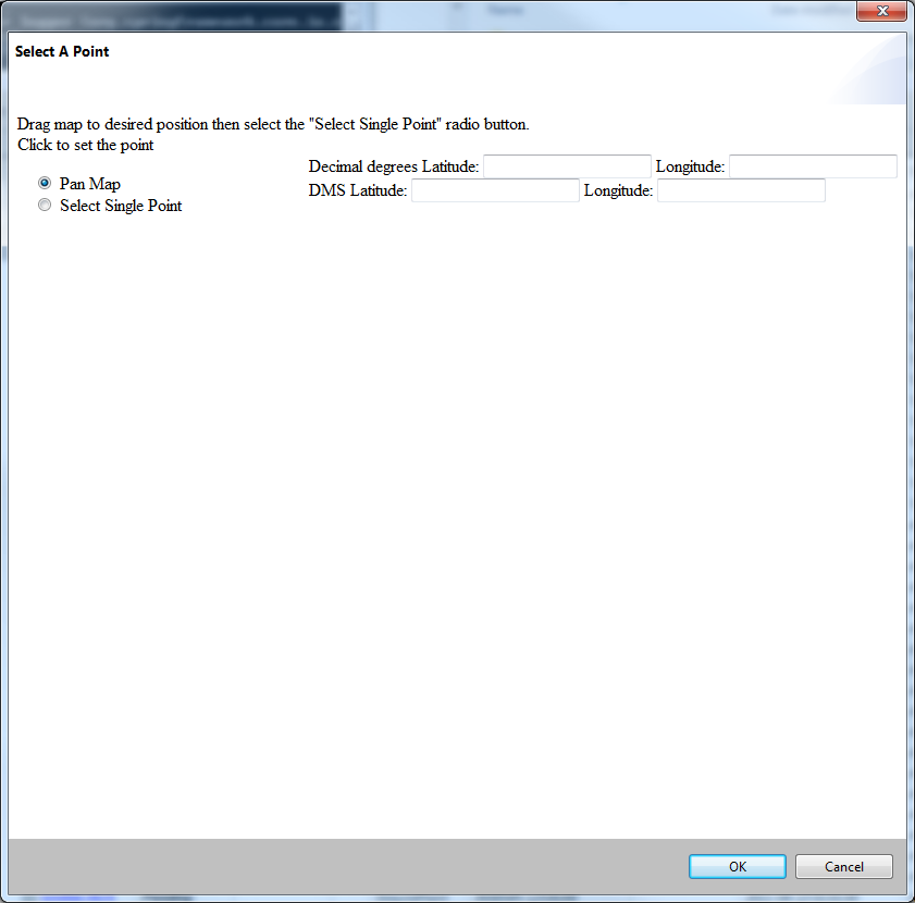

I have an Eclipse RCP application created using Indigo. Application includes an SWT Browser window. HTML for the browser window displays an OpenLayers map. HTML attached. When I run from the Eclipse IDE browser window displays correctly. After I export using the export wizard, the browser window will launch but the map does not appear. Two screen prints attached. There are no errors in the JAVA console, OSGI console shows the plugin active with no unsatisfied dependencies. I've verified the jar file is complete and that the plugin manifest class path contains all the folders.

When I load your map.html in my browser (typing this from an iPad) I see the same as your "Browser with HTML.png" as I don't have your OpenLayers.js or CoordinateDonverter.js available. Make sure those files are marked to be included in your build.properties.
Re: SWT Browser window displays incorrectly after exporting [message #901597 is a reply to message #901397] Mon, 13 August 2012 11:26 Go to previous message
Resolved, appears problem is trying to serve up all of the html and javascript files from the bundle jar. Moved the html and javascript to a webserver and used the full url in the setUrl on the browser and all is well.
