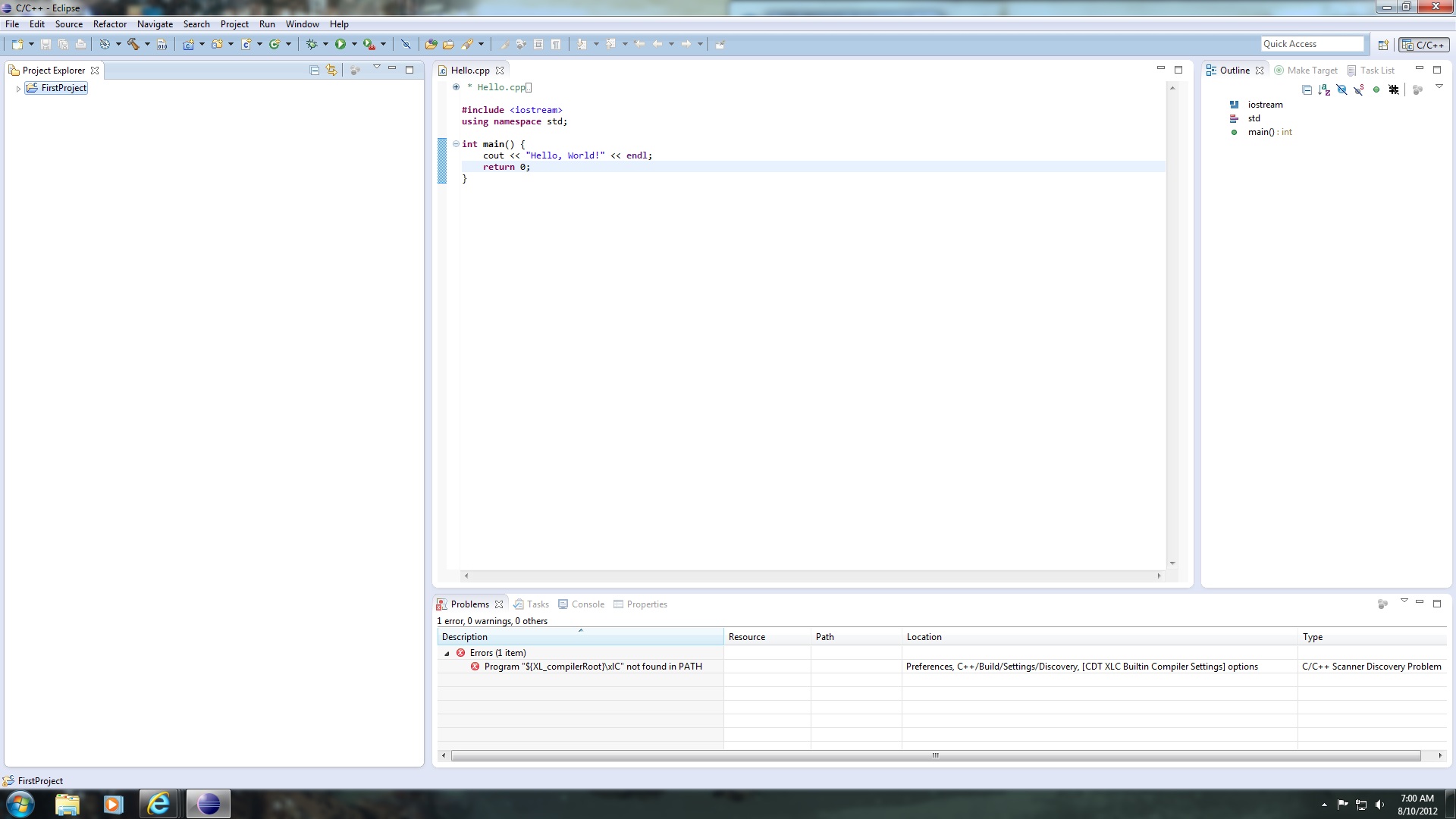

runs with pathing error [message #901224] Fri, 10 August 2012 08:20 Go to next message
Hopefully this is just a simple fix. First time setting this up and using it so I am a newbie to eclipse. I am Running Windows 7 and I am using the most rescent version of eclipse juno as of 8/8/2012 from the eclipse download site. I am using the cygwin cdt's. Through a process of following setup instructions from a few sites i have it setup at least to a point to where it will run the hello world program. But, it runs with a single error.
The Error is:
Program "${XL_compilerRoot}\xlC"not found in path
Now it also gives me a location to the issue and I have looked here with confusion to try and fix it.
Location is here:
Preferences,c++/Build/Settings/Discovery,[CDT XLC Builtin Compiler Settings] options
And i guess type is type of problem just sates:
C/C++ Scanner Discovery Problem

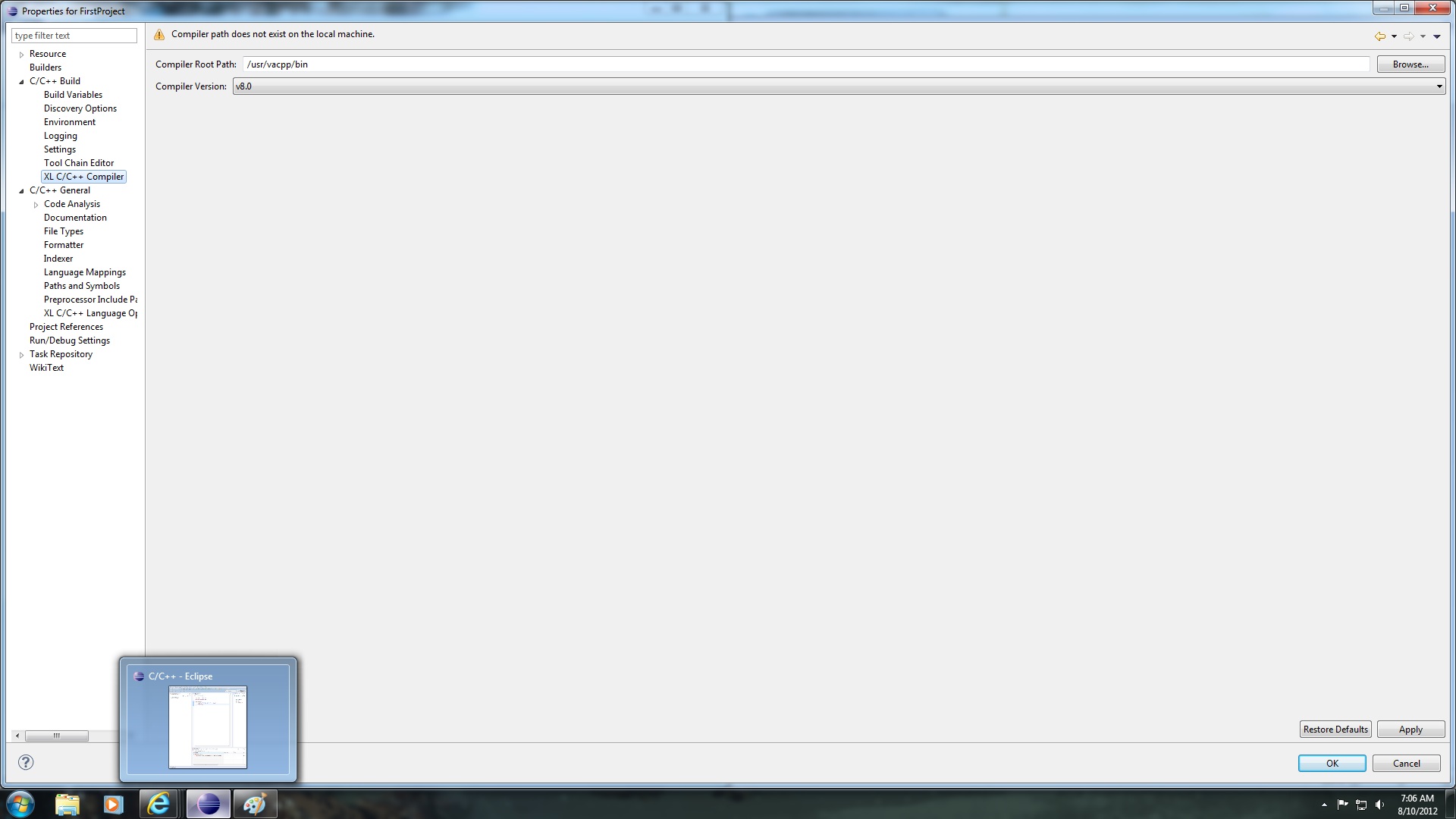

Now one thing I did notice, when i goto properties of the project -> C/C++ Build -> XL C/C++ Compiler (shown in C_C++_build.jpg) it shows compiler location of "/usr/vacpp/bin". I assume its referring to the cygwin folder. If it is, I do not see in the folders in my cygwin directory a vacpp folder. Which of course would explain the path error. I just would not understand though if cygwin sets up its folders based on the catagories you select, why would this folder not be created. I don't know i could be completely off too.

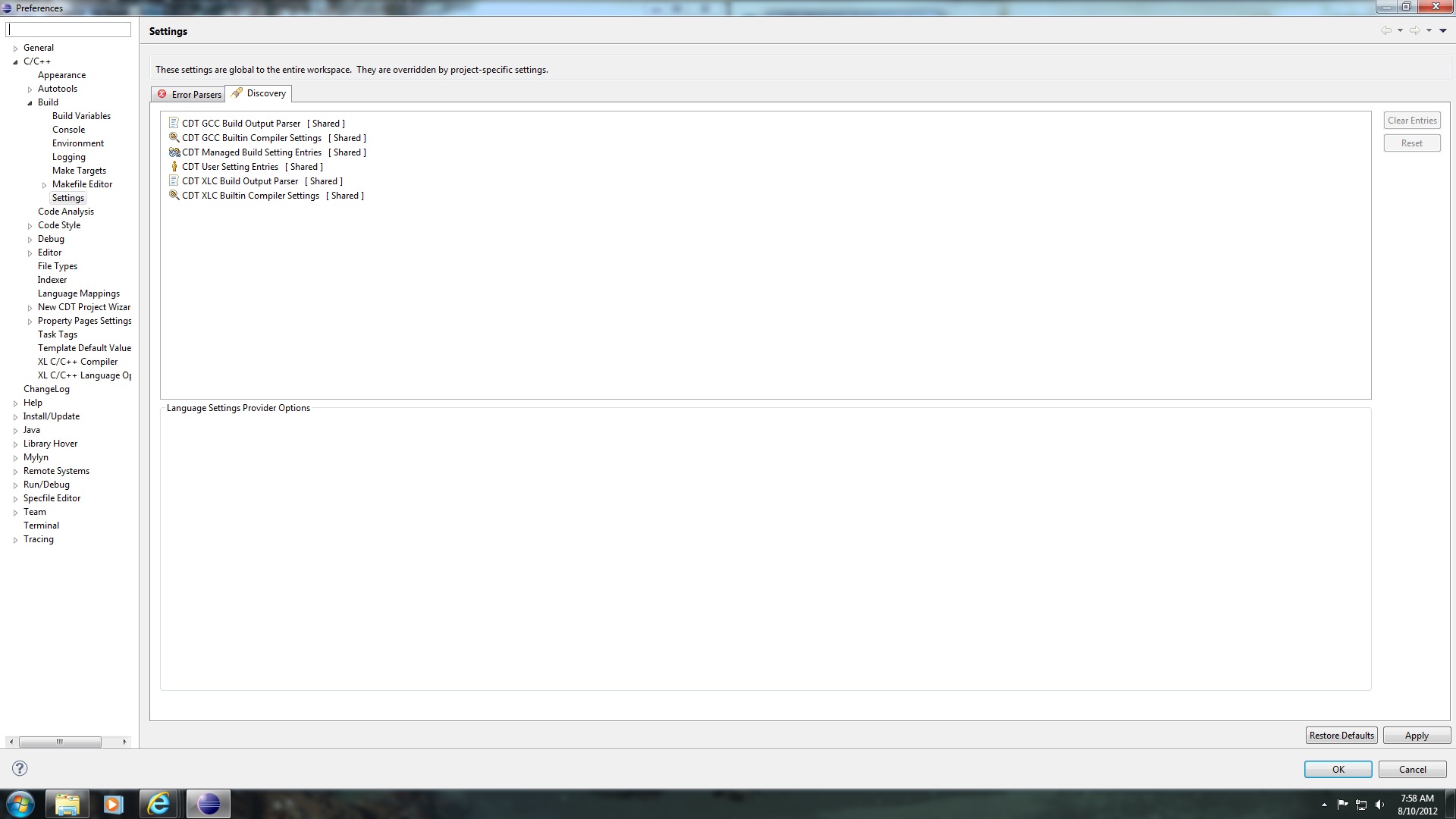

or do i just goto:
Window -> Preferences -> Build -> settings -> discovery and remove the CDT XLC output parser and Builtin Compiler settings? (shown in Build_settings.jpg)

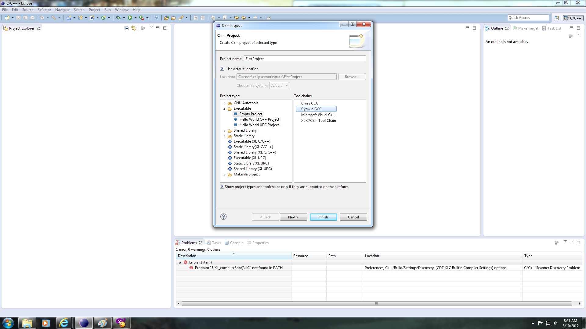

I did - when i created the project I gave it a name and under the Project type section there was a folder called executable and under that folder was 3 selections one of then called empty project which i selected. in the toolchains i had selected cygwin gcc. But this error keeps coming up. I'll remkae it again just to make sure. If i am makeing it right and it still comes up is there a way to disable the XLC since eclipse doesnt seem to let me deselect it?
Re: runs with pathing error [message #901248 is a reply to message #901243] Fri, 10 August 2012 09:39 Go to previous messageGo to next message

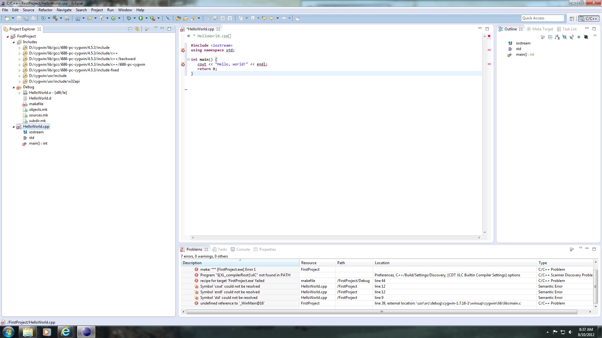

ok remade prject and now i get this - shown in (errors.jpg)
if it helps here is the project creation view - shown in (creation.jpg)
ok i guess ignore the error.jpg - i retyped it instead of copy and pasting it and they went away just have that XLC error still for some reason
OK, manually delete the error mentioning "Program "${XL....." by right
click the error and chose delete.
The other errors I do not understand, nor can I look into them as I do
not use/have Cygwin. You created the project using the "hello world" wizard?
