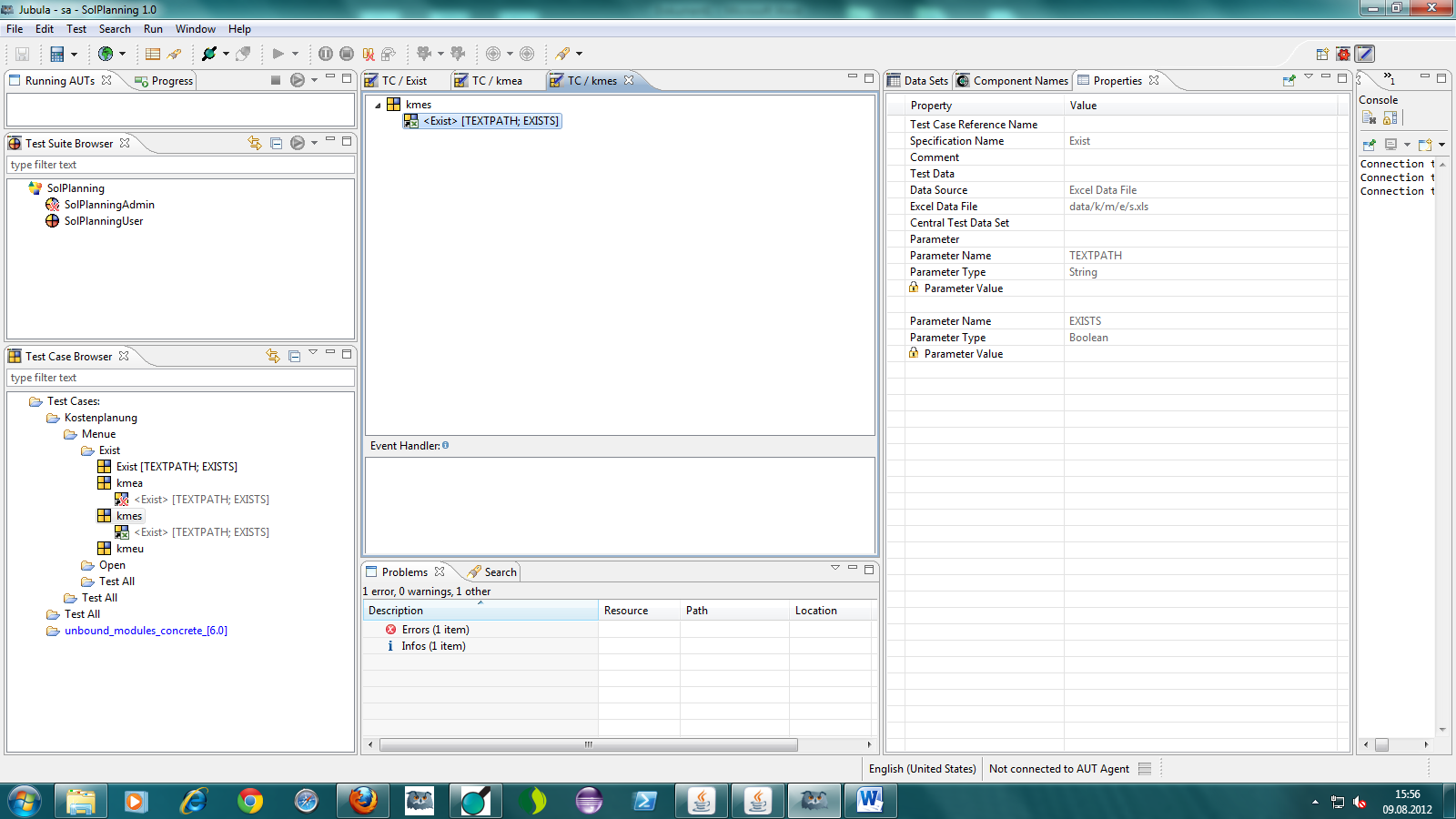

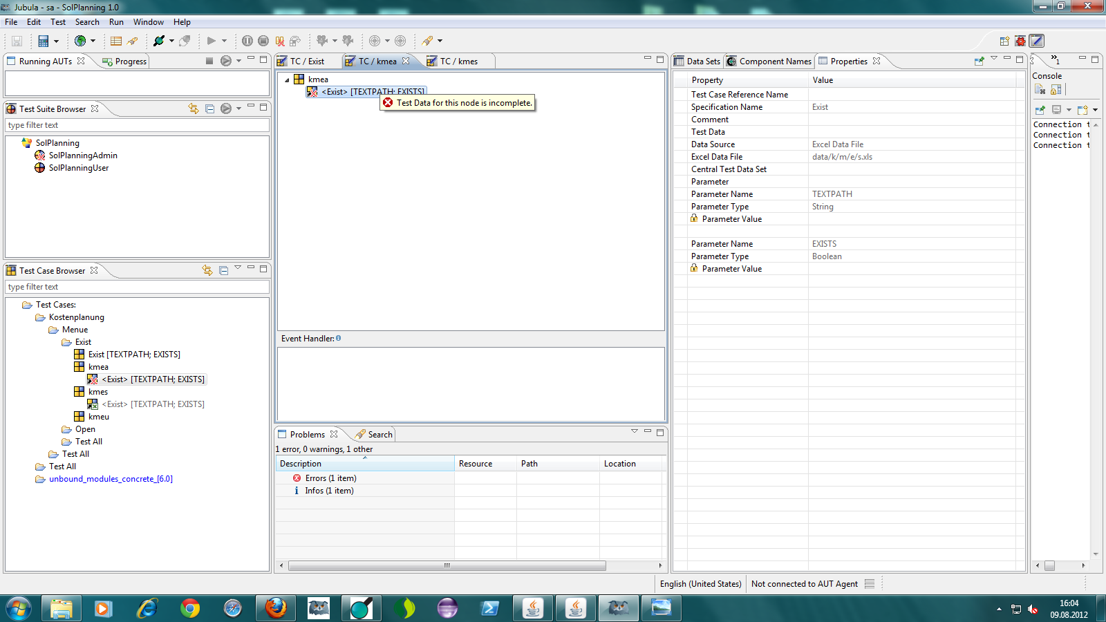

I work with Jubula now a view weeks but I can't solve this.
When I input a path to an Excel document my module get market erroneous and I can't start my test anymore.
If I try things like this:
* Comment the erroneous module out
* Save
* Comment the erroneous module in
* NOT save
* Execute the test
It is possible that the Error sign disappears.
The Error is solved also when I restart Jubula.
So it is possible that I have two modules which are equal and one is correct and one is erroneous.
What do I wrong.
Thanks for helping.
Andreas
Version: 1.2.1 (Standalone)
Bug: Test data for this node is incomplete.
Excel version: 2010
OS: Windows 7

It sounds like you may have run into this problem:
https://bugs.eclipse.org/bugs/show_bug.cgi?id=386368
There is a workaround described on the ticket that may help for now.
