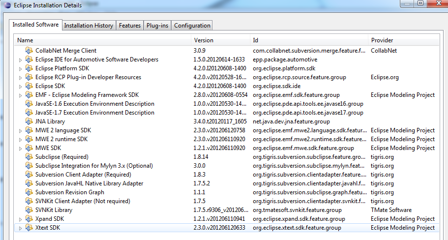

Re: [XPAND] Update of XPAND Content Assistant when changing Metamodel [message #901040 is a reply to message #900876] Thu, 09 August 2012 10:03 Go to previous messageGo to next message
When I just add the other plugin to the dependencies, I dont get any code assistant.
See picture for installed version.
