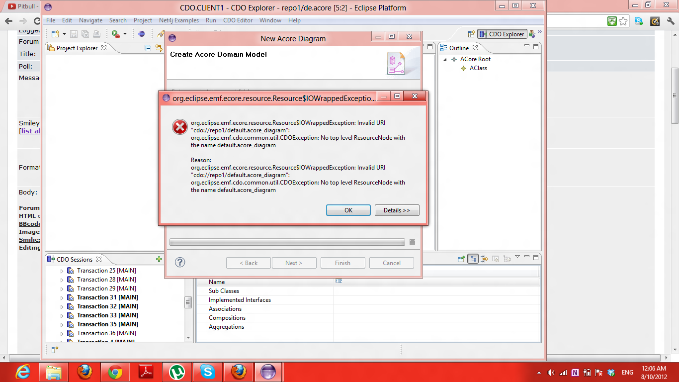

Re: Problem in the installed CDO Source [message #901116 is a reply to message #900678] Thu, 09 August 2012 17:04 Go to previous messageGo to next message
Now I can run it. I added all the plugins and ran the configuration. It works fine now.
But whenever I try to create a "Dawn Diagram", I get the following error message(Screenshot attached)

Re: Problem in the installed CDO Source [message #901129 is a reply to message #901116] Thu, 09 August 2012 18:13 Go to previous messageGo to next message
Also, in the editor, this error is shown:

> at
> org.eclipse.ui.internal.WorkbenchPage.openEditor(WorkbenchPage.java:2793)
> at
> org.eclipse.ui.internal.WorkbenchPage.openEditor(WorkbenchPage.java:2777)
> at
> org.eclipse.ui.internal.WorkbenchPage.openEditor(WorkbenchPage.java:2760)
> at
> org.eclipse.emf.cdo.dawn.ecoretools.diagram.part.DawnEcoreDiagramEditorUtil.openDiagram(DawnEcoreDiagramEditorUtil.java:68)
> at
> org.eclipse.emf.cdo.dawn.ecoretools.diagram.part.DawnEcoreCreationWizard$1.execute(DawnEcoreCreationWizard.java:81)
> at
> org.eclipse.ui.actions.WorkspaceModifyOperation$1.run(WorkspaceModifyOperation.java:106)
> at
> org.eclipse.core.internal.resources.Workspace.run(Workspace.java:2344)
> at
> org.eclipse.ui.actions.WorkspaceModifyOperation.run(WorkspaceModifyOperation.java:118)
> at
> org.eclipse.jface.operation.ModalContext.runInCurrentThread(ModalContext.java:464)
> at org.eclipse.jface.operation.ModalContext.run(ModalContext.java:372)
> at org.eclipse.jface.wizard.WizardDialog.run(WizardDialog.java:1028)
> at
> org.eclipse.emf.cdo.dawn.ecoretools.diagram.part.DawnEcoreCreationWizard.performFinish(DawnEcoreCreationWizard.java:93)
> at
> org.eclipse.jface.wizard.WizardDialog.finishPressed(WizardDialog.java:827)
> at
> org.eclipse.jface.wizard.WizardDialog.buttonPressed(WizardDialog.java:432)
> at org.eclipse.jface.dialogs.Dialog$2.widgetSelected(Dialog.java:624)
> at
> org.eclipse.swt.widgets.TypedListener.handleEvent(TypedListener.java:248)
> at org.eclipse.swt.widgets.EventTable.sendEvent(EventTable.java:84)
> at org.eclipse.swt.widgets.Widget.sendEvent(Widget.java:1053)
> at org.eclipse.swt.widgets.Display.runDeferredEvents(Display.java:4169)
> at org.eclipse.swt.widgets.Display.readAndDispatch(Display.java:3758)
> at org.eclipse.jface.window.Window.runEventLoop(Window.java:825)
> at org.eclipse.jface.window.Window.open(Window.java:801)
> at
> org.eclipse.ui.internal.handlers.WizardHandler$New.executeHandler(WizardHandler.java:259)
> at
> org.eclipse.ui.internal.handlers.WizardHandler.execute(WizardHandler.java:279)
> at
> org.eclipse.ui.internal.handlers.HandlerProxy.execute(HandlerProxy.java:293)
> at
> org.eclipse.core.commands.Command.executeWithChecks(Command.java:499)
> at
> org.eclipse.core.commands.ParameterizedCommand.executeWithChecks(ParameterizedCommand.java:508)
> at
> org.eclipse.ui.internal.handlers.HandlerService.executeCommand(HandlerService.java:169)
> at
> org.eclipse.ui.internal.handlers.SlaveHandlerService.executeCommand(SlaveHandlerService.java:241)
> at
> org.eclipse.ui.internal.actions.CommandAction.runWithEvent(CommandAction.java:157)
> at
> org.eclipse.jface.action.ActionContributionItem.handleWidgetSelection(ActionContributionItem.java:584)
> at
> org.eclipse.jface.action.ActionContributionItem.access$2(ActionContributionItem.java:501)
> at
> org.eclipse.jface.action.ActionContributionItem$5.handleEvent(ActionContributionItem.java:411)
> at org.eclipse.ui.internal.Workbench.runEventLoop(Workbench.java:2701)
> at org.eclipse.ui.internal.Workbench.runUI(Workbench.java:2665)
> at org.eclipse.ui.internal.Workbench.access$4(Workbench.java:2499)
> at org.eclipse.ui.internal.Workbench$7.run(Workbench.java:679)
> at
> org.eclipse.core.databinding.observable.Realm.runWithDefault(Realm.java:332)
> at
> org.eclipse.ui.internal.Workbench.createAndRunWorkbench(Workbench.java:668)
> at org.eclipse.ui.PlatformUI.createAndRunWorkbench(PlatformUI.java:149)
> at
> org.eclipse.ui.internal.ide.application.IDEApplication.start(IDEApplication.java:124)
> at
> org.eclipse.equinox.internal.app.EclipseAppHandle.run(EclipseAppHandle.java:196)
> at
> org.eclipse.core.runtime.internal.adaptor.EclipseAppLauncher.runApplication(EclipseAppLauncher.java:110)
> at
> org.eclipse.core.runtime.internal.adaptor.EclipseAppLauncher.start(EclipseAppLauncher.java:79)
> at
> org.eclipse.core.runtime.adaptor.EclipseStarter.run(EclipseStarter.java:353)
> at
> org.eclipse.core.runtime.adaptor.EclipseStarter.run(EclipseStarter.java:180)
> at sun.reflect.NativeMethodAccessorImpl.invoke(Unknown Source)
> at sun.reflect.DelegatingMethodAccessorImpl.invoke(Unknown Source)
> at java.lang.reflect.Method.invoke(Unknown Source)
> at org.eclipse.equinox.launcher.Main.invokeFramework(Main.java:629)
> at org.eclipse.equinox.launcher.Main.basicRun(Main.java:584)
> at org.eclipse.equinox.launcher.Main.run(Main.java:1438)
> at org.eclipse.equinox.launcher.Main.main(Main.java:1414)
