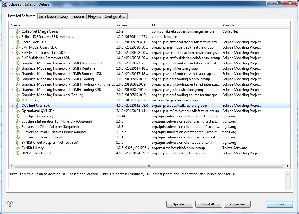

Iam not using OCL explicitly. Instead i have Updated OCL end user SDK through update site. Even after uninstalling OCL it is showing same error.
Please find the ecore file and list of installed updates in the attachments
