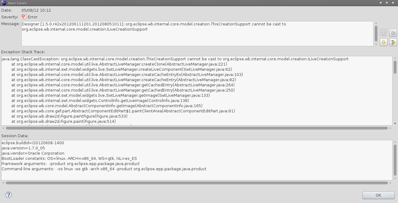

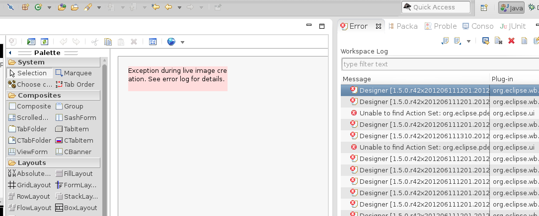

I have eclipse Juno installed under oracle jdk 1.7.0_05 in Bodhi Linux, and the visual editor does not seem to work. The steps I took were just upgrading windowbuilder, and installing the SWT toolkit.
Then I create a new SWT/JFace Java Project and adding a new Shell, and open the "Design" tab. An error is then shown that disallows the editor to be used (I uploaded a screen capture with the exception shown in the error log).
Just in case, the message in the event details is:
Designer [1.5.0.r42x201206111201.201208051011]: org.eclipse.wb.internal.core.model.creation.ThisCreationSupport cannot be cast to org.eclipse.wb.internal.core.model.creation.ILiveCreationSupport
The Stacktrace:
java.lang.ClassCastException: org.eclipse.wb.internal.core.model.creation.ThisCreationSupport cannot be cast to org.eclipse.wb.internal.core.model.creation.ILiveCreationSupport

And the session data:
eclipse.buildId=I20120608-1400
java.version=1.7.0_05
BootLoader constants: OS=linux, ARCH=x86_64, WS=gtk, NL=es_ES
Framework arguments: -product org.eclipse.epp.package.java.product
Command-line arguments: -os linux -ws gtk -arch x86_64 -product org.eclipse.epp.package.java.product
I've tried to reinstall eclipse and Windowbuilder several times, to no avail. Any clue?
