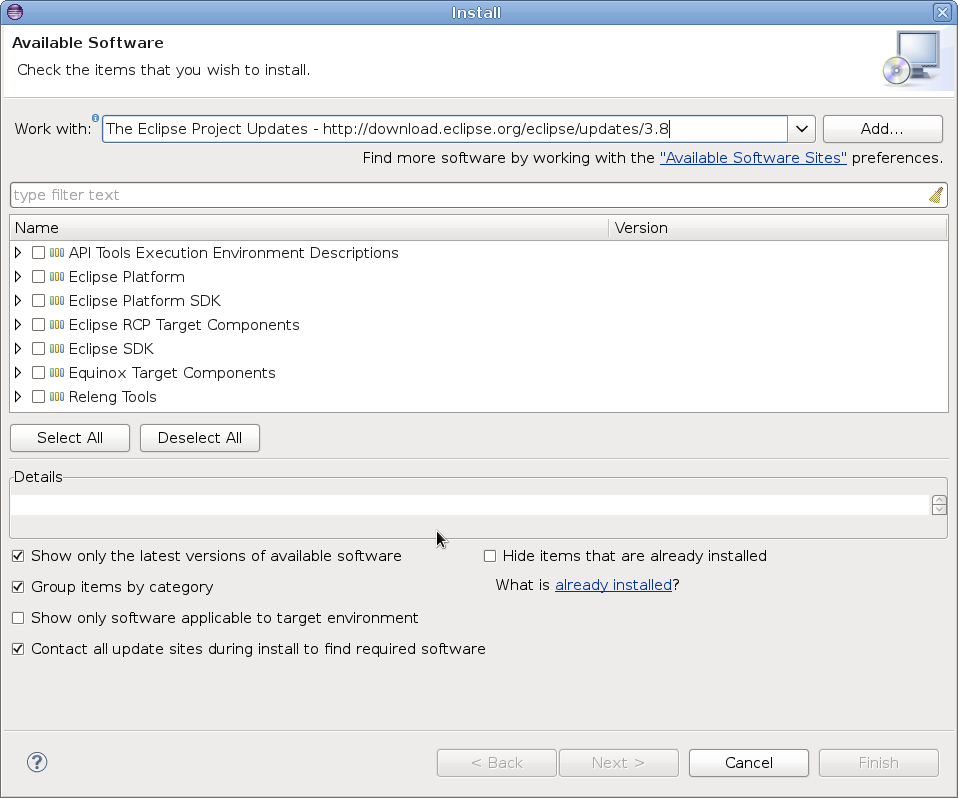

I just downloaded the 3.8 targz. I unzipped it, launched, immediately went to Help | Install New Software. For "Work with" I selected "The Eclipse Project Updates - http://download.eclipse.org/eclipse/updates/3.8".
I am presented with a list of items with checkboxes. I really have no idea what any of them mean as they all use acronyms I never heard of. Which, if any, should I install? Please see attached.
The ones I find particularly confusing are:
"Eclipse Platform" -- What is an "eclipse platform" and don't I have it already?
"Eclipse Platform SDK" -- same question
"Eclipse SDK" -- same question
Thank you for your help. And if you can "teach me to fish" by referring me to a documentation site, please do, I'd be happy to read more about these platforms and sdks.
Thank you,
Chris
PS: My ultimate goal is to write c++ code with eclipse which will require me to install something called the CDT.
  • Attachment: install.png
    (Size: 76.44KB, Downloaded 165 times)

Core and UI-Framework e.g. to build RCP applications
Eclipse Platform SDK + JDT + PDE
