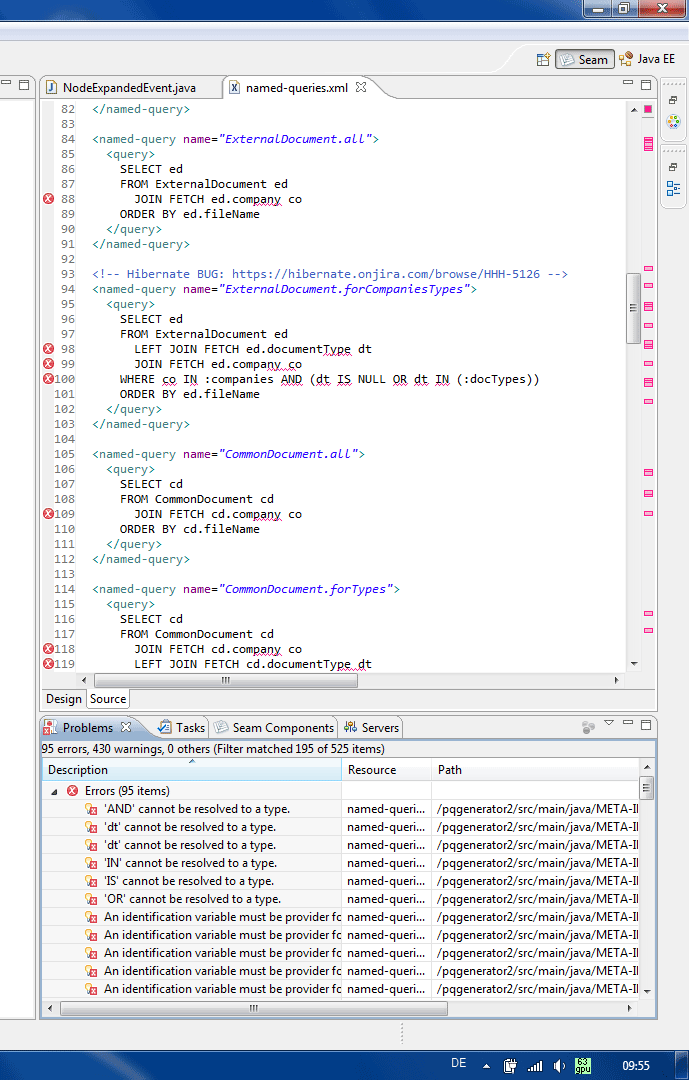

There are several errors in the XML editor:
Multiple annotations found at this line:
- The abstract schema type 'co' is unknown.
- The FROM clause has 'IndividualDocument id JOIN FETCH id.company' and 'co LEFT JOIN FETCH
id.documentType' that are not separated by a comma.
- An identification variable must be provider for a range variable declaration.
- The abstract schema type 'dt' is unknown.
- The FROM clause has 'co LEFT JOIN FETCH id.documentType' and 'dt ' that are not separated by a
comma.
- The identification variable 'dt' is not defined in the FROM clause.
- The IN expression does not have a valid state field path expression or TYPE expession.
- The left parenthesis is missing from the IN expression.
The above query is just an example. The file is full of validation errors:
index.php/fa/11021/0/
Everything is working fine with Hibernate as JPA provider, so I assume this one and other queries to be correct. There are no problems with the mappings (code is generated, assume this as working).

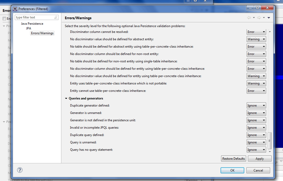

Problem is, as suggested here http://www.eclipse.org/forums/index.php/mv/msg/359515/882912/#msg_882912, that I already set all Errors/Warnings in my workspace settings to "Ignore":
index.php/fa/11022/0/
However, this doesn't do ANYTHING... I cleaned and re-built the project several times - nothing. Errors still there.
How do you *globally* turn off this whole Dali validation stuff? It would suffice to turn off all JPQL/named-queries.xml validation somewhere.

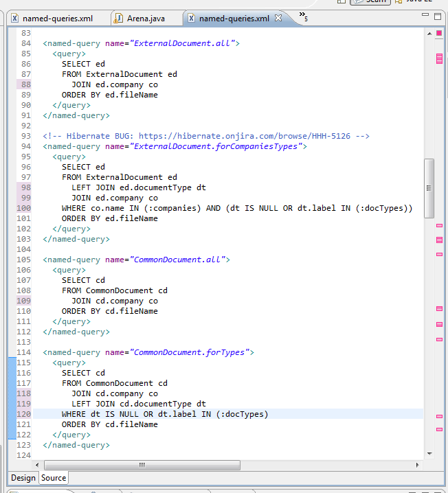

Here's the end result:
index.php/fa/11028/0/
Currently looks like 3 bugs in one statement... YUCK

Sorry you are running into problems with the JPQL validation. We should have some answers for these issues shortly. There is a way to turn off automatic JPA validation in Eclipse. In the workspace preferences or project properties select the Validation tab. Here you can disable JPA Validation in whole, or you can go click the settings button and turn off validation specifically for ORM Mapping files (content type).
Neil
